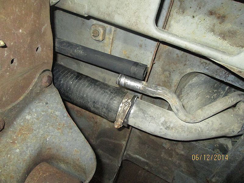

Might be a vent hose on the filler neck tubing, Mike? Depending on the configuration, the metal vent tubing connects to a 3/4 hose that hooks to the tank below. Need to see how the plumbing is done. This is my 88 E-150.

Not sure about your year van, but I've got the same problem on my 93 after I had the fuel pump replaced. It commonly occurs because the hose between the neck and tank develops cracks.
