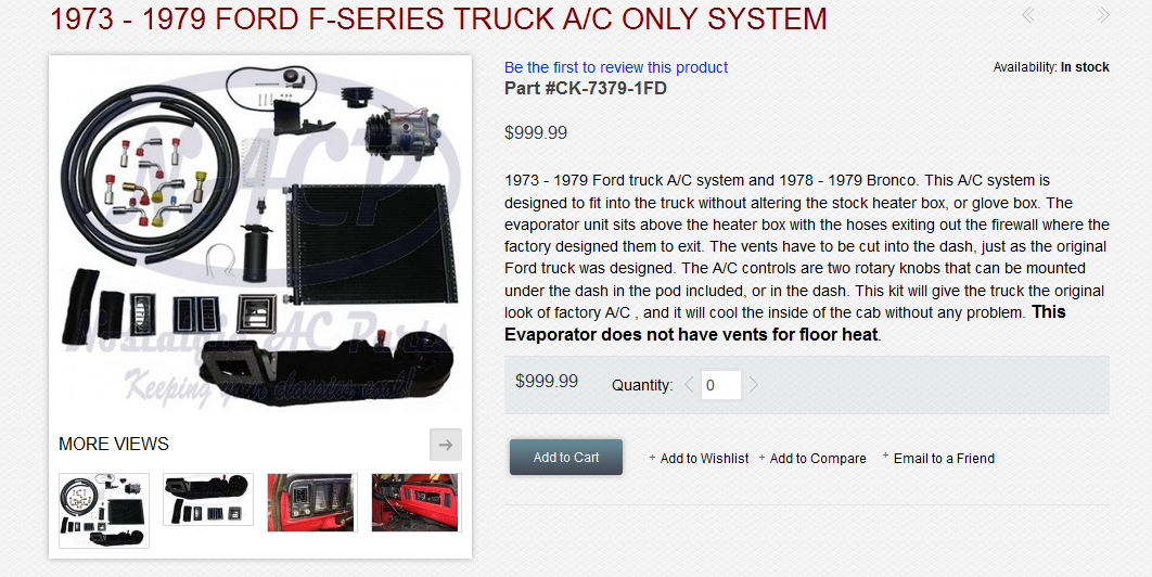

So this is a unit that DOESNT need a big hole in the firewall and DOESNT replace my glove box? Also I want to use all the factory flash vents. I want cold Ac in my truck now lol. How about compressor? How does all that work? And can you post some pics??
Old May 4, 2016 | 03:46 PM
Canus's Avatar
Canus
Joined: Apr 2012
Posts: 324
From: Spencer Mountain, NC
Not cheap but should be an easy install.
