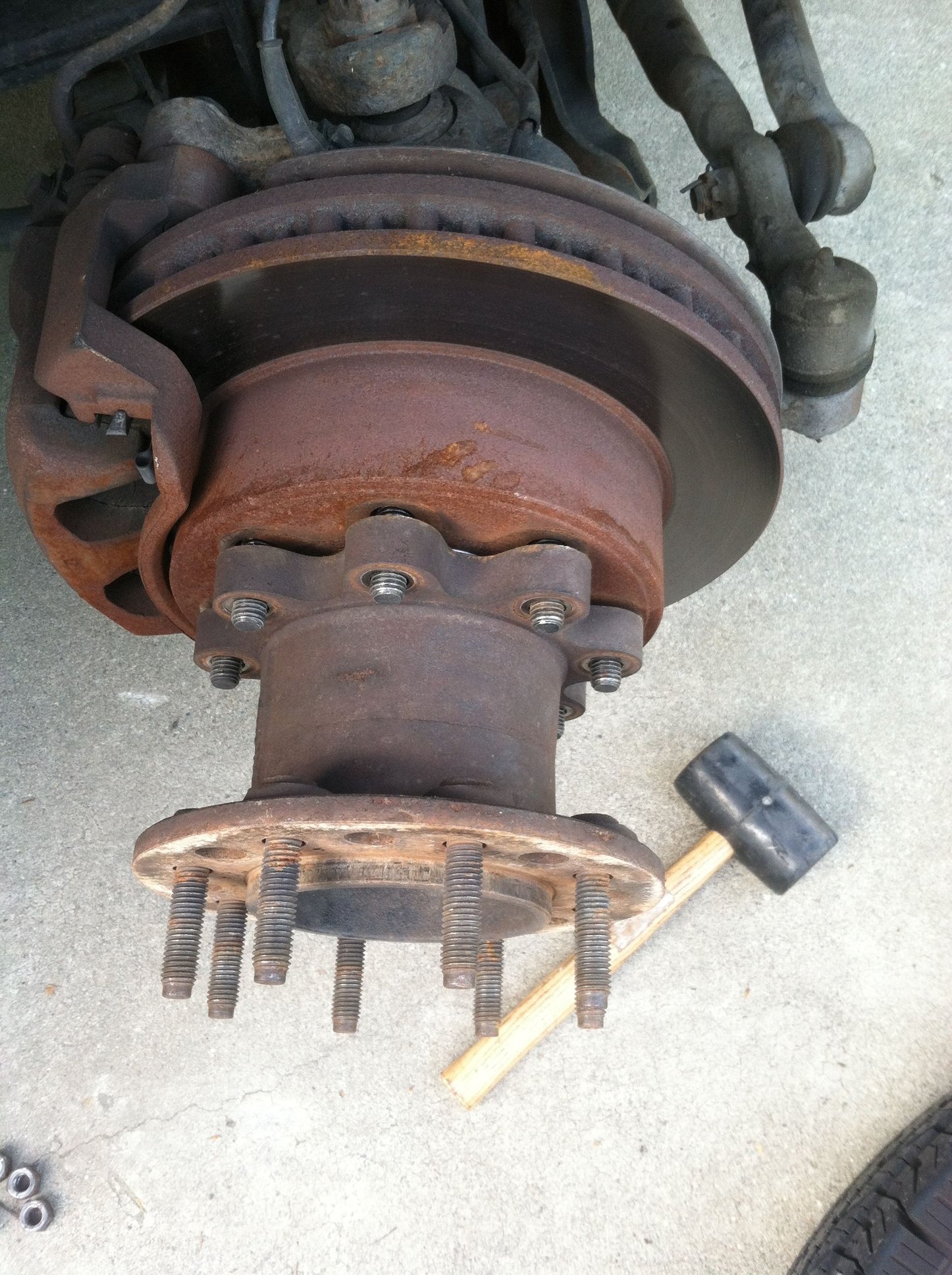

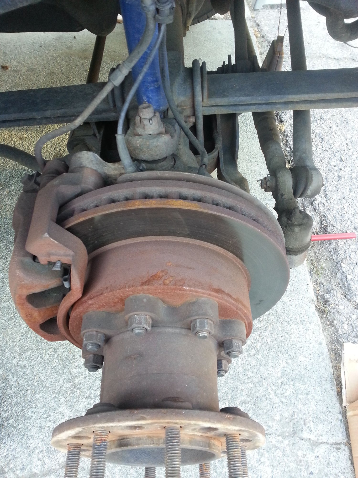

ok, I got the passenger side done. Here are some pictures.
You need powertools. There is no way to get the nuts out. BTW, it is 21mm and heavy duty to say the least.
Use soft hammer to get it all loose and it will slide out. Once here, the process of replacing will be same as SWR.

Oh, rotor change as well! Your first pic the rotor looked fine.
