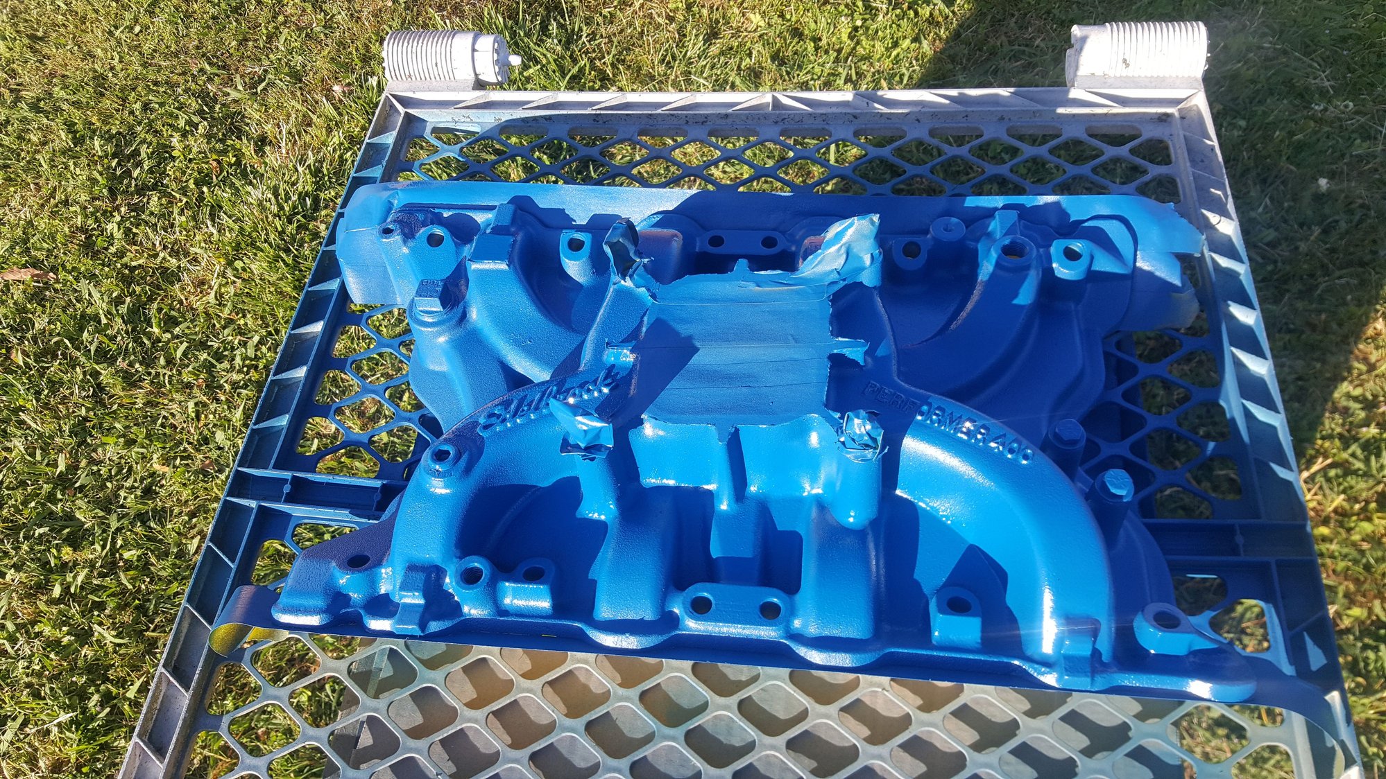

I have everything except the part that has the chain and the bracket. Does that mount to the intake? If so will it mount to an Edelbrock manifold?

My edelbrock intake for my 460 had the mounting holes tapped for the cruise servo. My bracket also bolts the the back of the cylinder head if I remember correctly. I had to add some oversize nuts as spacers to get my bracket to line up with the back cylinder head hole. Possibly need a throttle return spring bracket that I am missing. But spacers worked fine.
I would think the performer intake for a 351m or 400 would also have the right holes for a ford servo bracket.

Here's my intake. Thanks for info

The two places where you have bolts installed is where the bracket mounts.

Okay great. There's a bracket that goes there. The carb spring attached there. The servo could fit on top. Thanks.

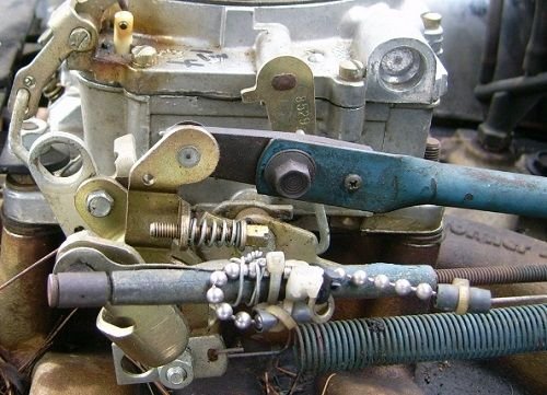

Reviving this thread because I have been unable to find either of the two styles of throttle linkage attachments for the cruise servo chain. There is one that attaches directly to the carb throttle linkage and this one pictured here that is part of the cable itself. Anyone got any leads on this? My truck is a 79 with factory cruise, but the cable does not have the piece on the end. Just a ball clip. And I have the cable, not the rod. I'd take the plastic piece on the carb itself, but am guessing that is harder to come by and makes it more difficult for upgrades later.
Well, that quickly I think i figured it out. Looks like either the wrong, or optional cable on mine. The ends are different where this piece would clip on to. Mine is a simple ball clip, others seem to have an elongated barrel shape with a pin on the end to locate the clip.
Originally Posted by orangeford
Here is a closeup of my servo setup. Like I said I used a longer chain which is riveted to the servo piece that moves. You can probably use a light chain from a hardware store to extend if needed for the 4 barrel carb. I had to extend my auto trans kickdown lever too, see the gold colored piece on black kickdown rod.
The servo has red and blue connectors.

The plastic piece fits over both of the connectors you just showed. Then a pin holds it against the rod or cable should work with either.

Before I found the plastic throttle connector in a junkyard my old one was broken and I just used wire to attach. They might be pretty tough to find but look in vans or cars with carburetors. I havent found any reproductions.

Thanks again. I should have gone and looked my cable was just right for the clip. Had the little nub on the end and all. Got the clip I pictured before and it fits great. May find a stiff piece of plastic I can slit over the cable to help support it all, but as you can see the piece referenced elsewhere that attaches to the carb linkage wouldn't work with this carb.
