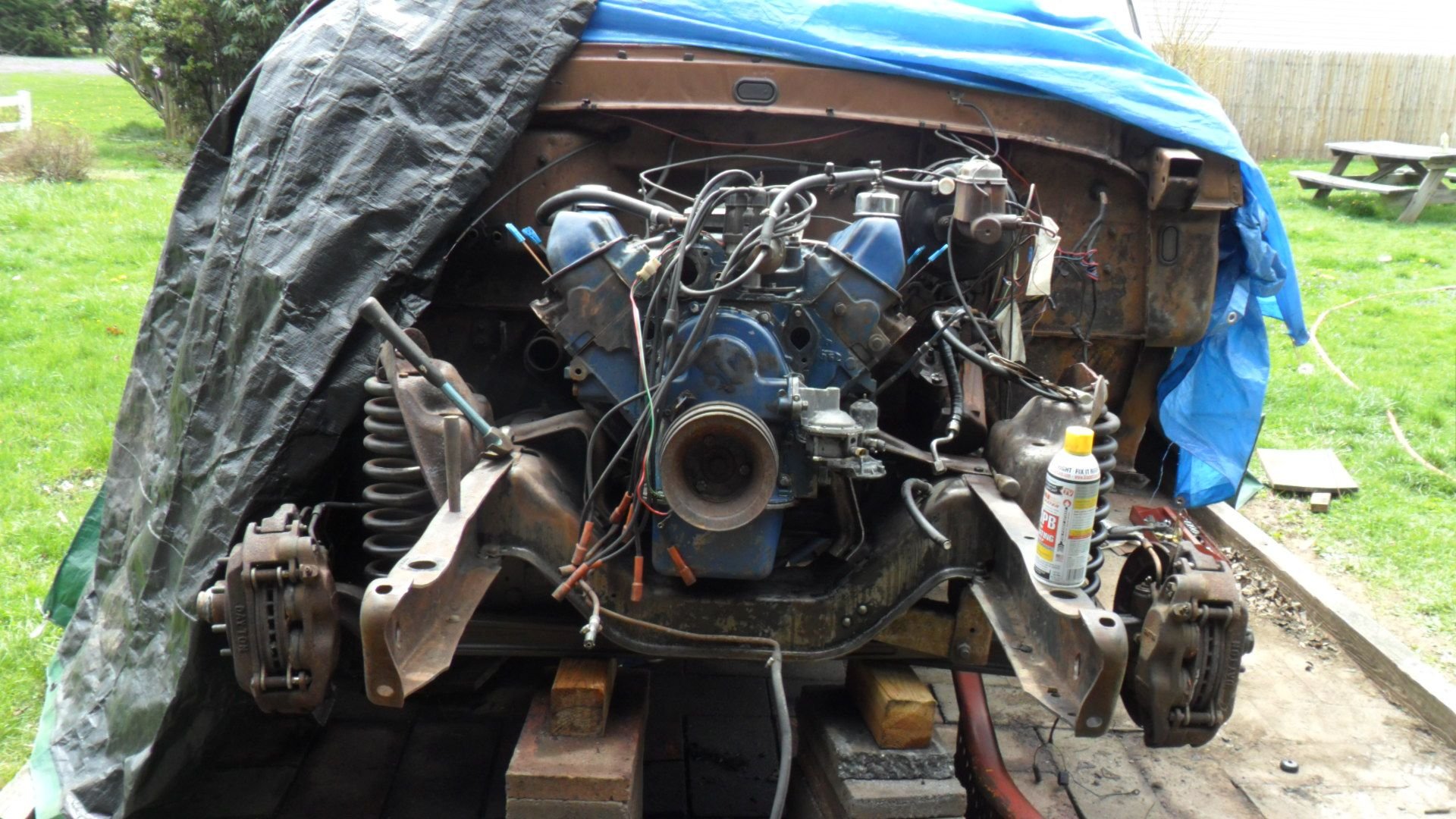

Who would replace the fuel pump i
f you were this far?

Not me... only if it were suspect or really old.
I'd pull the engine and refinish the frame and engine if I were that deep into it.

I don't have the capability to pull the engine or I would have. Where the truck sits right now I would have to build a pretty strong tripod that would probably need to be about 8 feet tall, and that's if I lowered the truck as far as possible.
Joewilker, No it doesn't need replacing. I'll keep it. If it craps the bed it's a pretty easy replacement.

Hope those concrete blocks are at least solid and not hollow core. I prefer wood blocks because concrete sometimes crumbles with a little vibration.

I did notice the hammer and the can of PB Blaster. What it is it's coming loose!

Thanks for the thought. I have backup as well so if they fail while I'm working I won't get crushed.

I can't get the pitman arm loose. I really want to remove the steering box so I can get in to really clean the engine. I've got three issues right now. A broken bolt from the water pump, the stubborn pitman, and finding a new exhaust manifold or a 428 from a car.
It has custom dual exhaust and I'm not in the position to modify it right now.

Get a pitman arm puller from Harbor Freight. Or borrow one from O"rieliys or Autozone.

If you want originality, then change the pump because it appears to be wrong, doesn't have the filter canister.
