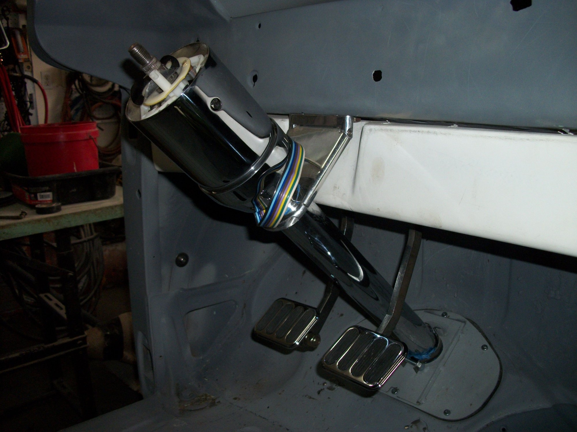

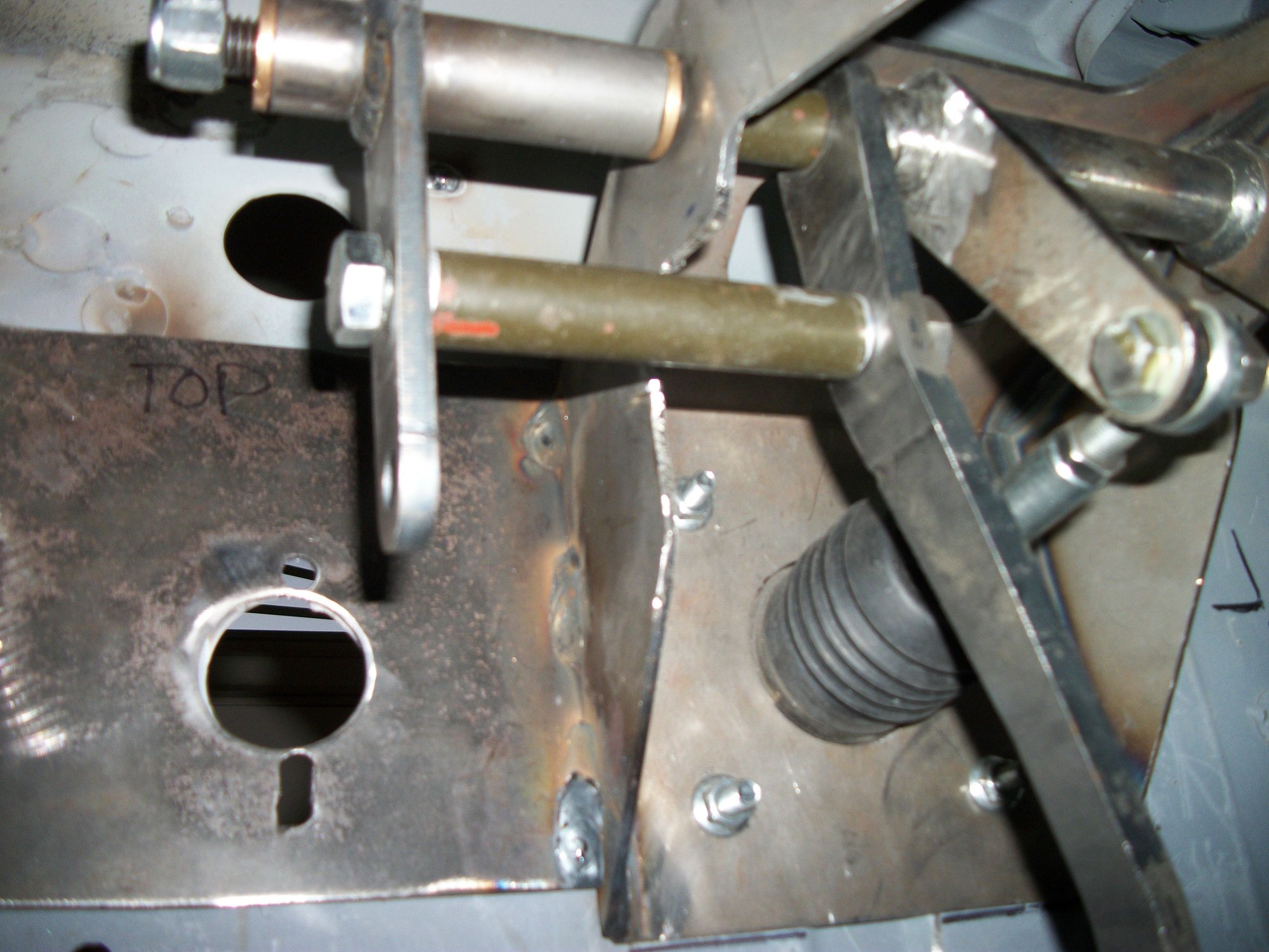

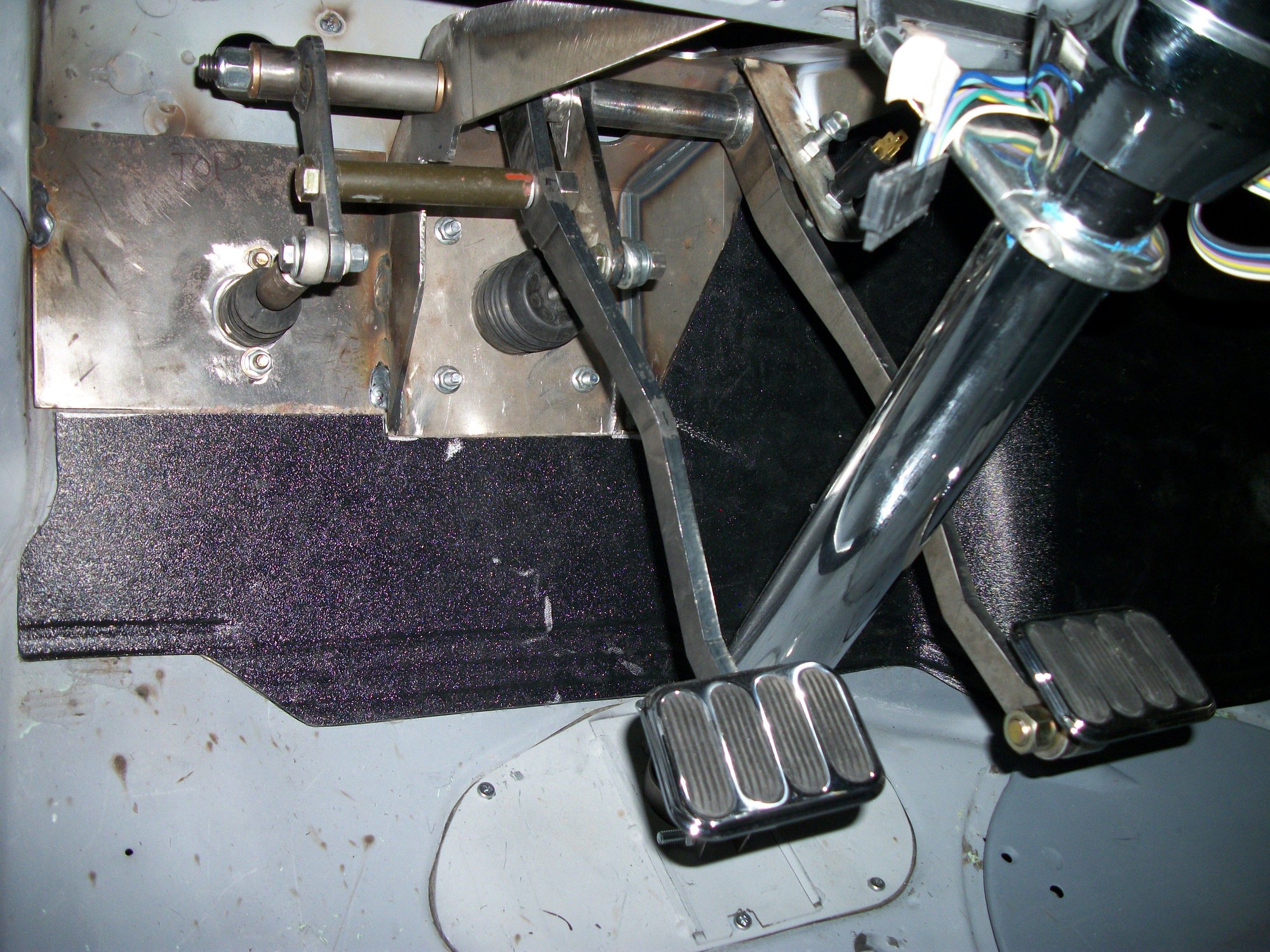

Finally got back home for a few days. Have to leave on Sunday. Here are the pics I promised. Both the master cylinder and master clutch assembly had a threaded rod affixed to each. I made some spacers and threaded each end so I would have adjustment on the pedals for each. Have not got a pic of the masters installed yet. Hope I can find some time to install and will post them. having problems posting pics will try later. pics are in gallery not sure why they are not downloading. Still can not download to this thread. have the completed brake pedal assembly done. Finally got the pics to download, Not a 100% done but close.
Jonesy

Finally got the pictures to download. Not a perfect job but it should work
