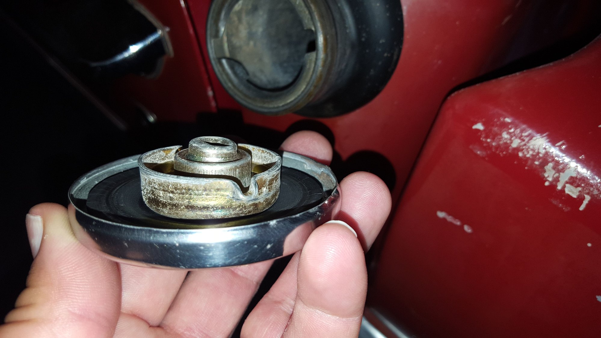

thanks......here's a pic of the 1 that fits shortbed, but not my longbed
Yep. That's the Vented cap.
