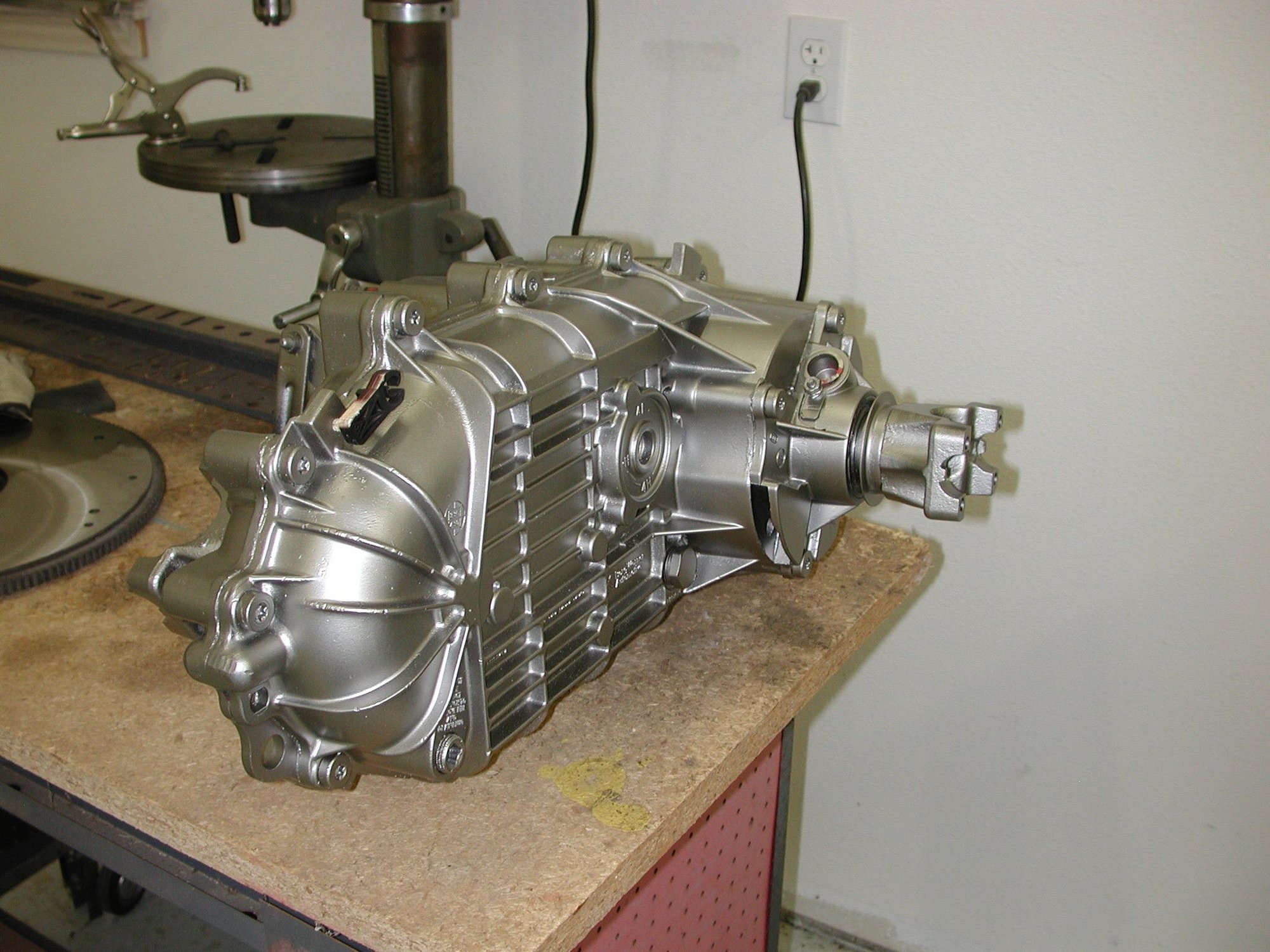

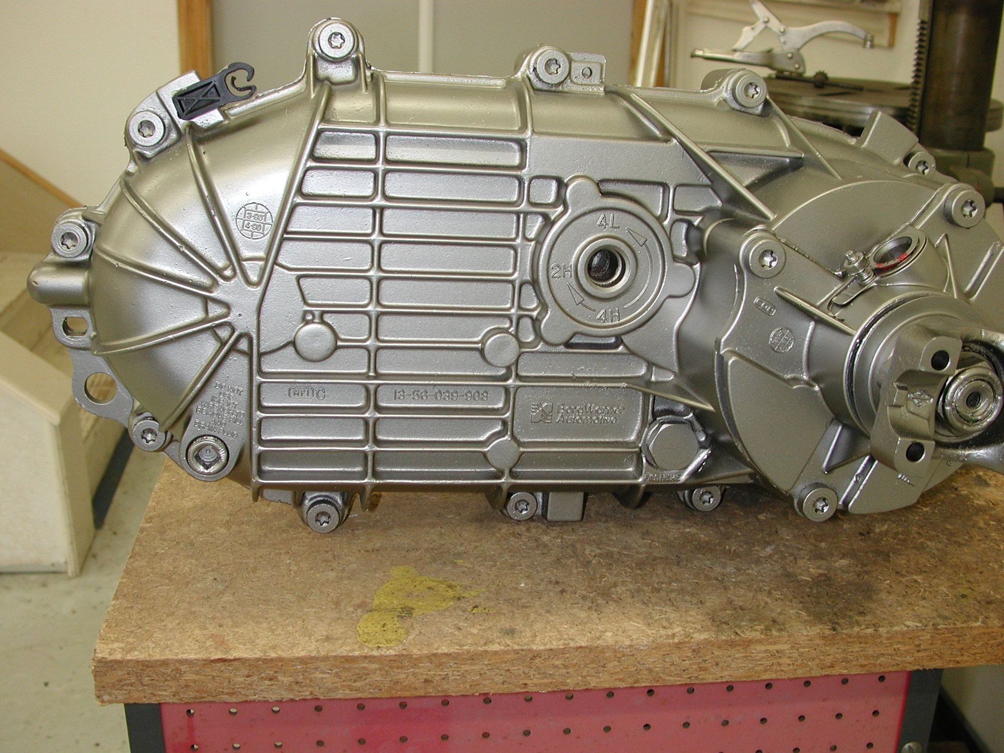

Originally Posted by bruno2
Brad, I have a 96 F250. I have always thought the T case was a 1356. Mine is equipped with the 7.3 and the ZF5. Is there a way to ID the T case?
How quickly they forget. Does this look familiar? The lump you hauled in your truck? That spent several weeks across the street from your old house? This is a BW1356, as confirmed with the "13-56" cast into the housing in the middle of the pic:
Originally Posted by Diesel_Brad
VERY easy to tell a 4407 from a 1356.
The tag on the back of the t-case is the easiest,
Then if you had them side by side the 4407 is much bigger
The 4407 has a flat flange the drive shaft bolts to, the 1356 is a slip yoke
Brad - Not all 1356's had slip yokes. This one is configured as a Bronco unit with the smaller u-joint yoke up front and rear. There was also a Bronco unit with a small fixed yoke up front and a flange on the rear to which a fixed yoke attached. Then there were the ones for the F250's and 350's which did get into slip yokes. This was discussed in ad nauseum in one of my 8-page micro analyses: https://www.ford-trucks.com/forums/1...-a-bw1356.html
Here that t-case is before the conversion to a Bronco style unit. It is the one on the left and the NP208 it is replacing is on the right. Note that it has a larger fixed yoke in front, a slip yoke in the rear, and an aluminum front half and magnesium rear. That's because it has the PTO cover on the front, which is because it came from an F350. If it didn't have the PTO cover it would have magnesium cases front and rear.
I dint feel like getting into the different 1356s available thru the years and different trucks. I just wanted to point out the differences for the 1356 and 4407 that would of came in a F250/f350
Got it. Thanks. So, the "before" picture is a 1356 from an F350 w/a 460.
