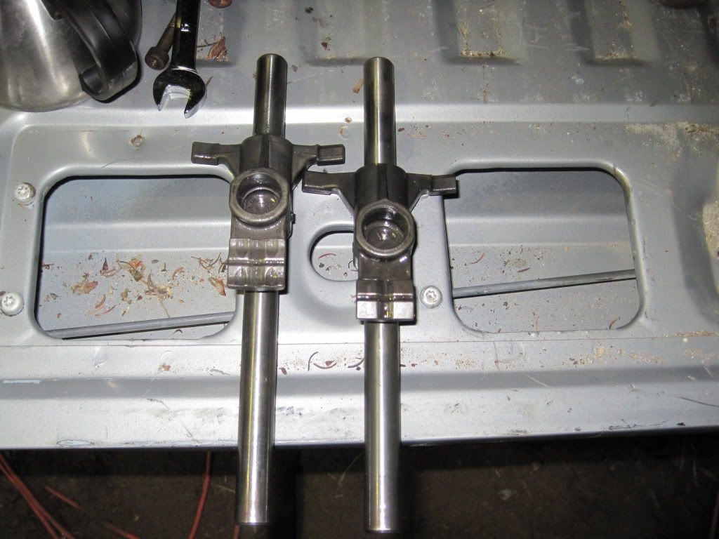

The shift shaft differs between the -42 and -47 and the bore depth in the housing reflects this.
On a -42 the deeper bore is on the front half of the case, on the -47 it's on the rear half. You can put a -42 front half on a -47, with no modifications other than shimming. A -47 front half with a -42 rear half you end up with both short bores. You might be able to shorten the shaft, but if may end up too short to stay engaged in the bores.
