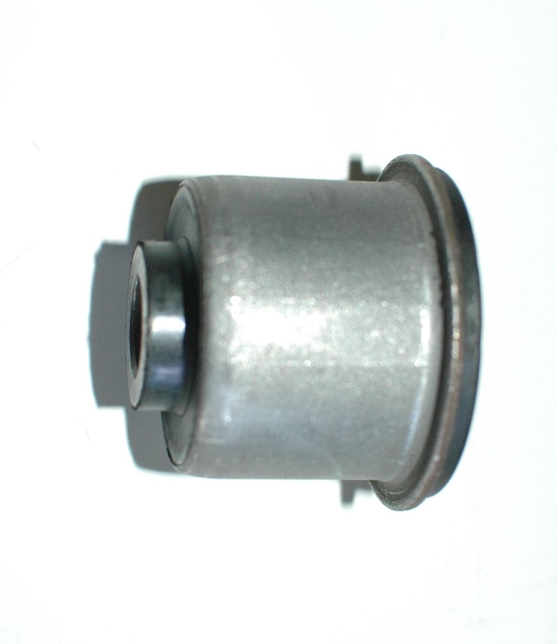

the replacement urethane bushing are "engineered" to fit in the bare I beam. the steel sleeve is bonded to the OEM bushing..
Also correct, much like these OEM axle pivot bushings:
(These ^^ are NOT sway bar bushings, simply images showing similar parts.)
