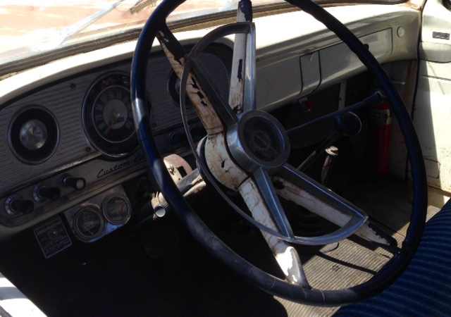

you can see the top of the housing on the other side of the column, it has a long levr that is spring loaded. I think it saws WARNER on the round housingName:  FullSizeRender.jpg

acctually you can see the lever too

Mico brake, truck running, step FIRMLY on brakes, apply button or toggle switch, release brake pedal, release button or switch. Brakes are locked, prob fronts and rears. DO NOT USE THIS when truck is not attended, it's not parking brake, it's for when the truck is being used for it's work purpose. To release the brakes, simply step firmly on brake pedal and release.
Truck is probably an F-350 judging by the parking brake handle on floor next to the trans shifter. It is attached to the rear of the trans.
Guessing this truck was used for test boring as you say looks like an engine was mounted in the bed. Or possibly a Co that did well service.

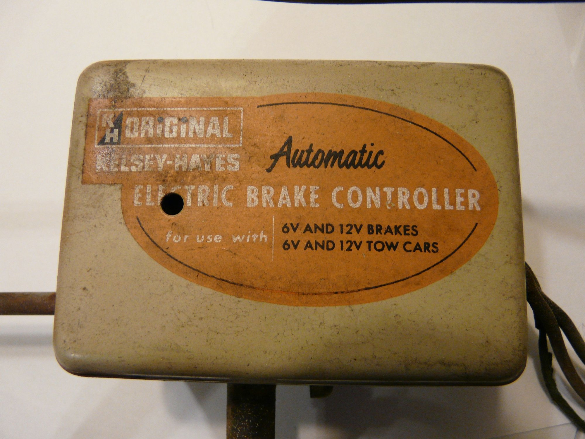

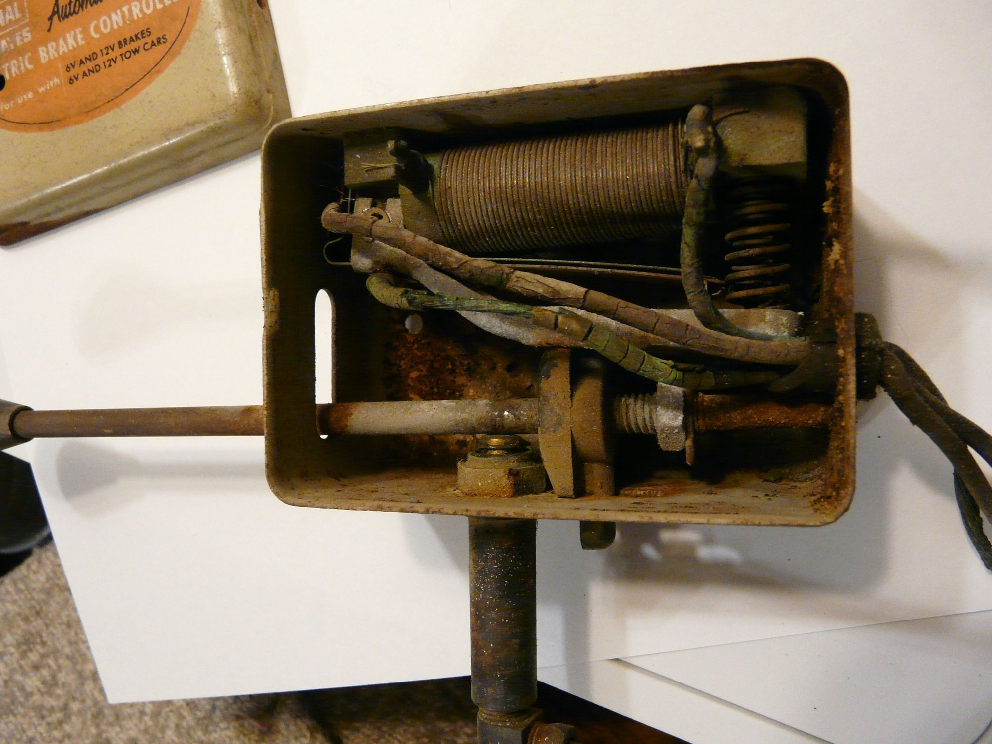

Controller on column is for Brakes on a trailer. If lever moves when you step on brake pedal it may operate a rheostat for electric brakes on trailer. The brakes could be hyd if a connector near trailer hitch has a brake line going to it.
The '64 F250 I picked up last year had a trailer brake controller that was operated by the hand lever and it was connected to the brake lines so that when you stepped on the brakes it operated a small piston that moved the lever as if you were doing it by hand. It has been disconnected for a while.
