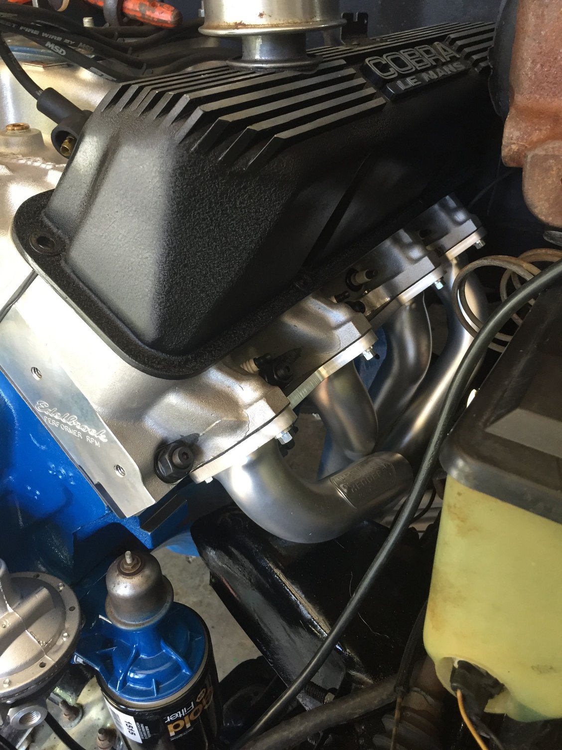

1+ year old thread but this looks like a good place to put pictures of the Sanderson FF427's I have installed on my 390 FE 4x4. Hopefully these are useful to those looking to do this in the future.
Here's the Sanderson FF427's with a standard size starter in place.
In order to get the mini starter to fit properly without hitting the engine block I had to rotate the mounting plate clockwise, so that the holes all the way to the left (holes counterclockwise to center) were used for the allen screws.
I also realized that I had to take the mounting plate off to mount the bottom bolt prior to installation because the bolt would not fit once the plate was tightened down. This made it a real pain to try to tighten down this bolt, so I decided against mounting it this way. I may put a bolt in from the bellhousing side with a nut on the starter side.
Here's the Sanderson FF427's with a Summit brand mini starter.
The starter stud is on the inside next to the engine, so a longer cable is needed to have enough distance to run up to the solenoid.
