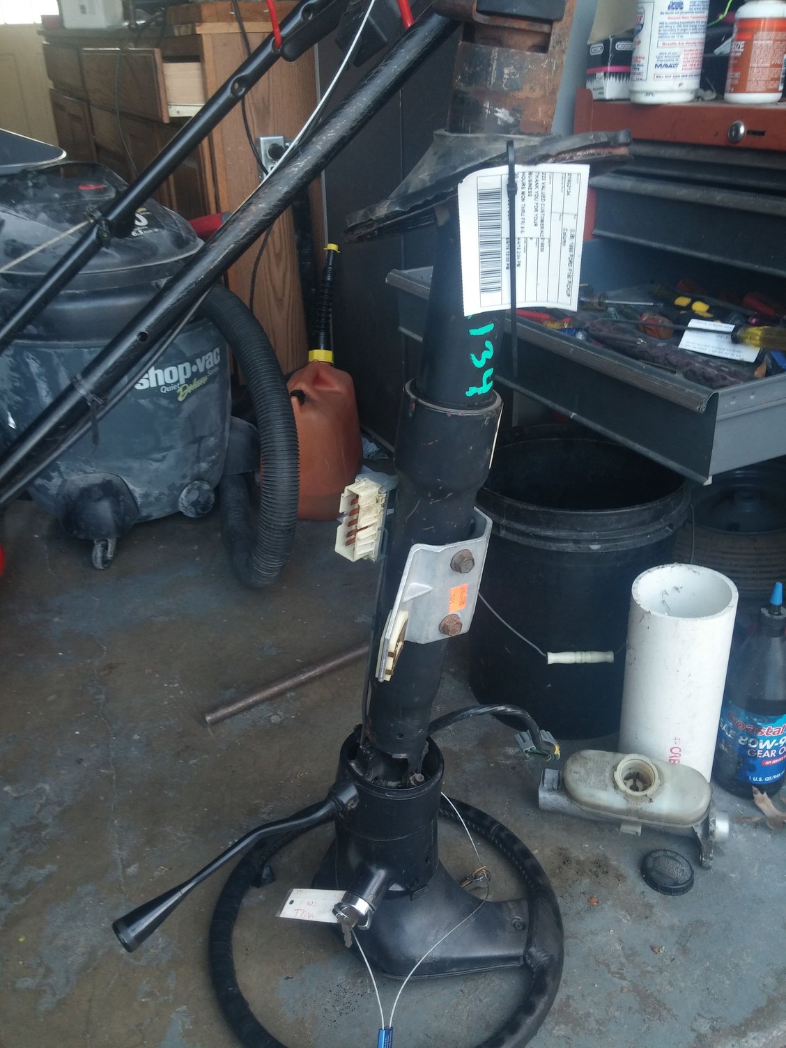

Here is my replacement column this was all I was going to replace. Not the whole thing. I wish I could though! So is it ok just to remove the bolt up by the shift linkage? Or no? Thanks for all the help on this!!!!!!

as long as the lower part is ok, that is fine.
but you are still going to need 2 people to get that in. someone is going to have to align the shaft into the column, otherwise you will pull all your hair out trying to do it yourself.

figures, man I wished I had known that! Which do u go with chilton manuals? Or do you not like those either? And also doesnt the ignition switch on the column have to be in a certain spot when they are installed? But no i was talking about the plug in switch on the lower part, of the column! Not the key cylinder. My used column has the cylinder with to sets of keys already... Thanks again tjc for your help!!!!!

This, is what the one looks like on the replacement column! Thanks!

if the white plastic part is tight to the aluminum part like it looks, go with the one on the column. if it is bad you will know rite away, it will be loose.
to replace it you unbolt it and pop it off the column, the rod will be sticking up, but it comes rote out of the switch. then just set the new switch on the rod and put the bolts in loose. turn key to accessory position and pull the switch tight to the rod, then tighten the bolts. once tight, run the key through all the positions.
i change switches in the truck, and just make sure they are properly adjusted before putting the column up tight to the dash.
