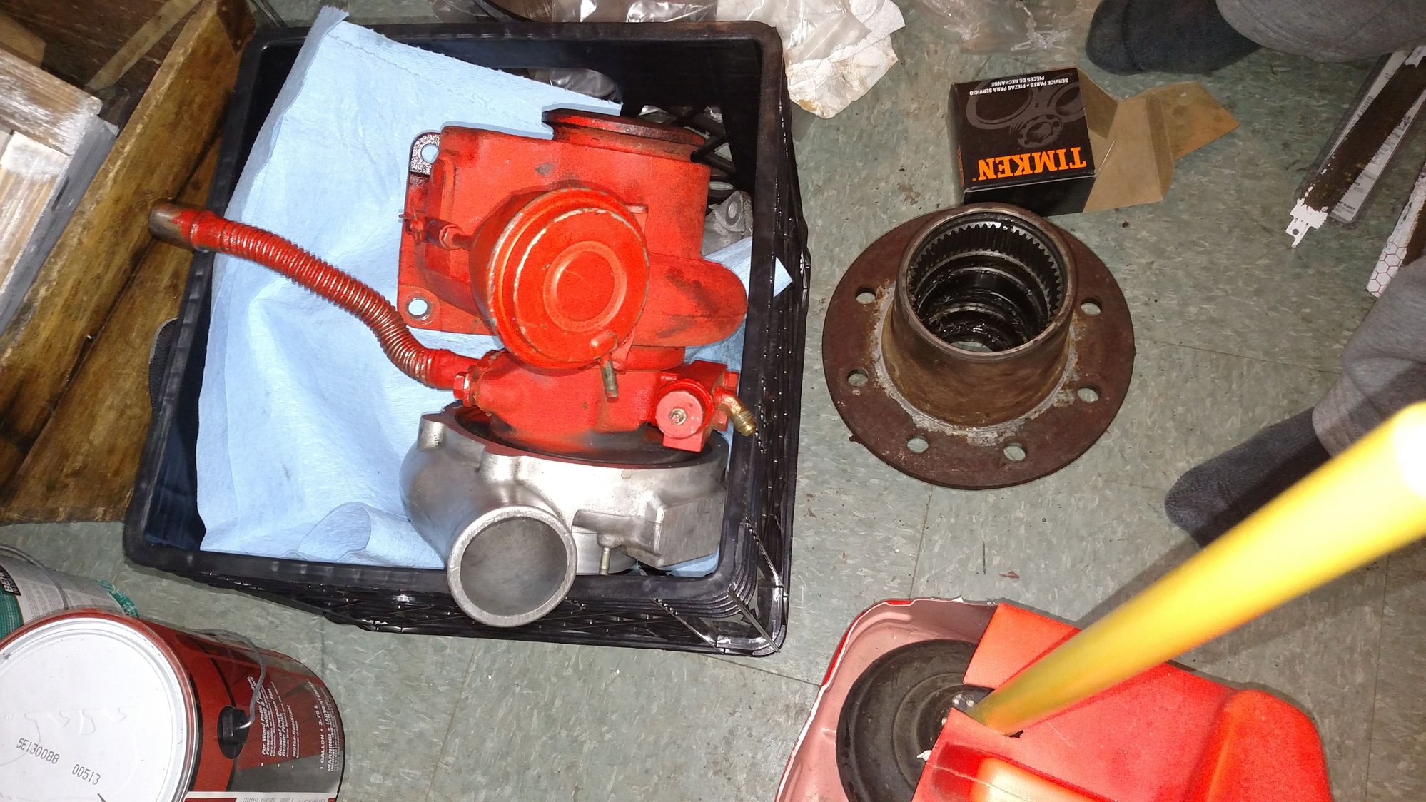

Sorry guys, I've been pretty busy the past few days so I havent taken many pictures or even gotten much done. I got the front suspension out and also my PSD turbo off. I can feel a bit of play in the shaft, which kind of worries me. How much play is too much? Also how do I get the compressor housing off? I am trying to put my new Riffraff wheel on but it does not want to budge even with the bolts out! Also got the rest of the front axle housing ground down so it is being painted now, but is being delayed because of rain. Now messing with the frame to put the leafs on will be the next tricky part. Dont know exactly what I am going to do. FInally, I think I might put an e-fuel setup on while everything is apart. Any recommendations to use? I think I'm going to get a Bosch 69136, which is the stock super duty pump if I am understanding correctly. What filter bases have you all used? I would like to do a 10 micron pre and a 2 micron post filter setup, preferably with CAT filters.
Some pics of the front suspension once out:
