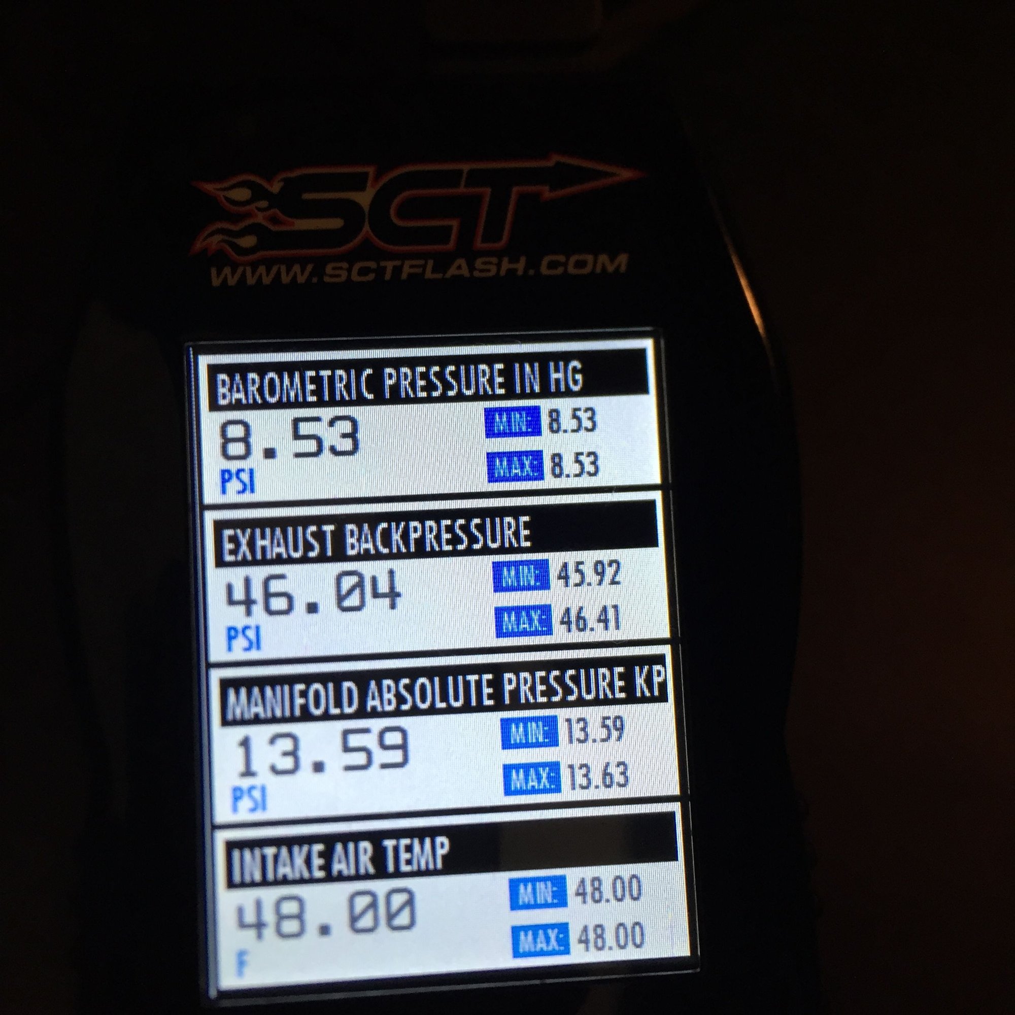

I just hooked up my SCT tuner to my 7.3L Excursion. Look familiar? These reading are not at all in line when I hooked up AutoEnginuity. I should have done this last night! But I'm a dumb a$$......I got the SCT for the 6.0L , didn't think it would connect to the 7.3L till I tried.
It's not your sensors or PCM- it's the SCT not getting it right.
It's not your sensors or PCM- it's the SCT.

Don't mean to totally bash the SCT tuner here. It does have some nice features, I can adjust the idle rpm's, change the shift points, do some data logging (on the PID's that work correctly) and load e-mailed custom tunes to it.
It would be awesome if it read the Baro & EBP sensors correctly........

Sorry, I've been busy with some family in town.
Wow, WB! Thank you for that. It's okay with me if you bash SCT. If they say it should work with a 7.3 diesel, it should work. Period. I'm glad I already had it and didn't buy it specifically for this truck. Regardless, you've saved me a bunch of time and money. My bluetooth adapter for Torque Pro should show up today. I'll take a look at everything then. During this process, I've discovered a couple of different boost leaks. I also found the blown out EBP tube. So, bottom line, the end result is positive. And, I'm glad I didn't spend any more money.

No problem, that's what FTE is all about. We've all been in a similar situation when troubleshooting. I've been on this site for @ 10 years and I can't thank all the folks enough that helped me along the way.
Glad it got figured out before you went PCM shopping!
