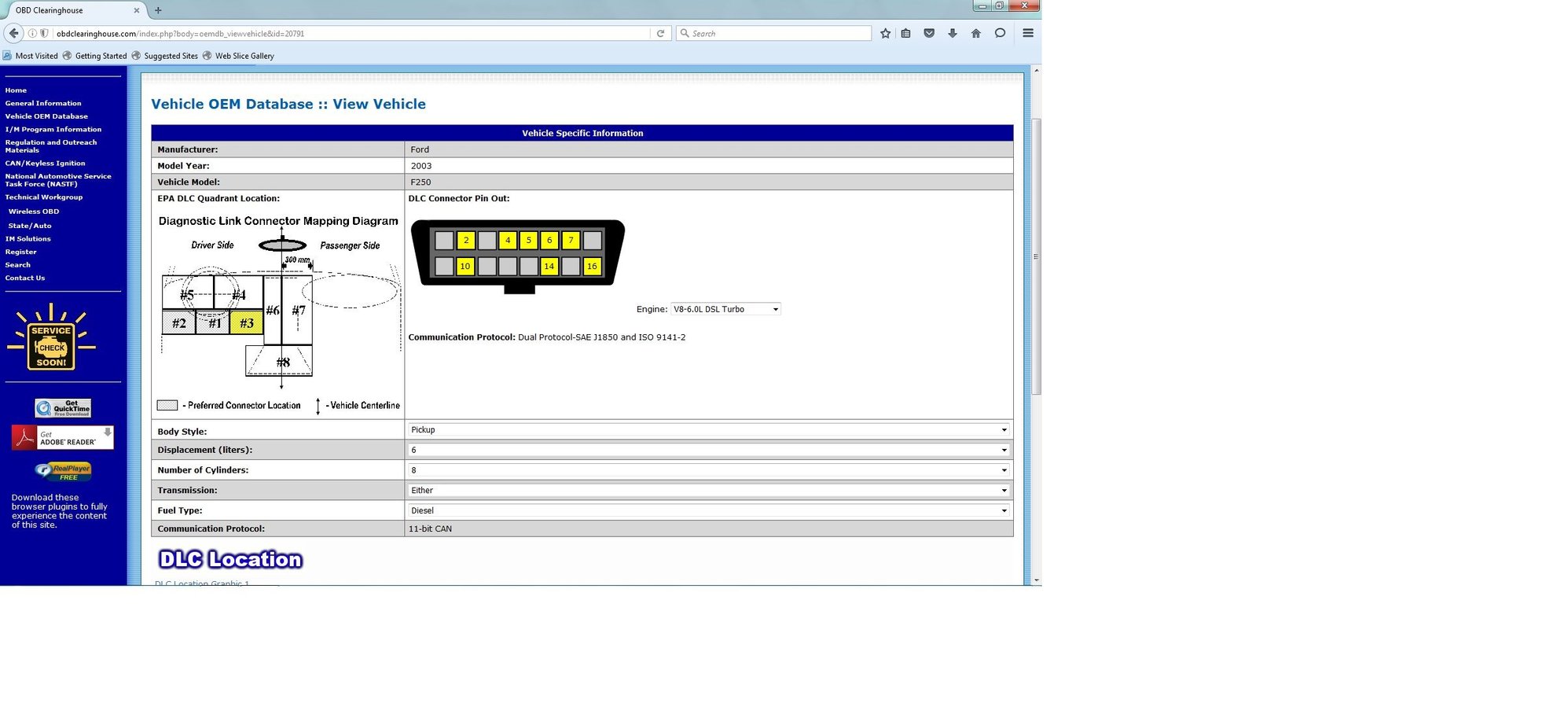

I have tried slowing it down. I did find this interesting though
It list three protocols for communications.

Got it working. Had to set the protocol in my profile to "Automatic Thorough" and it hooked right up. I did also re-pair it with my phone.
