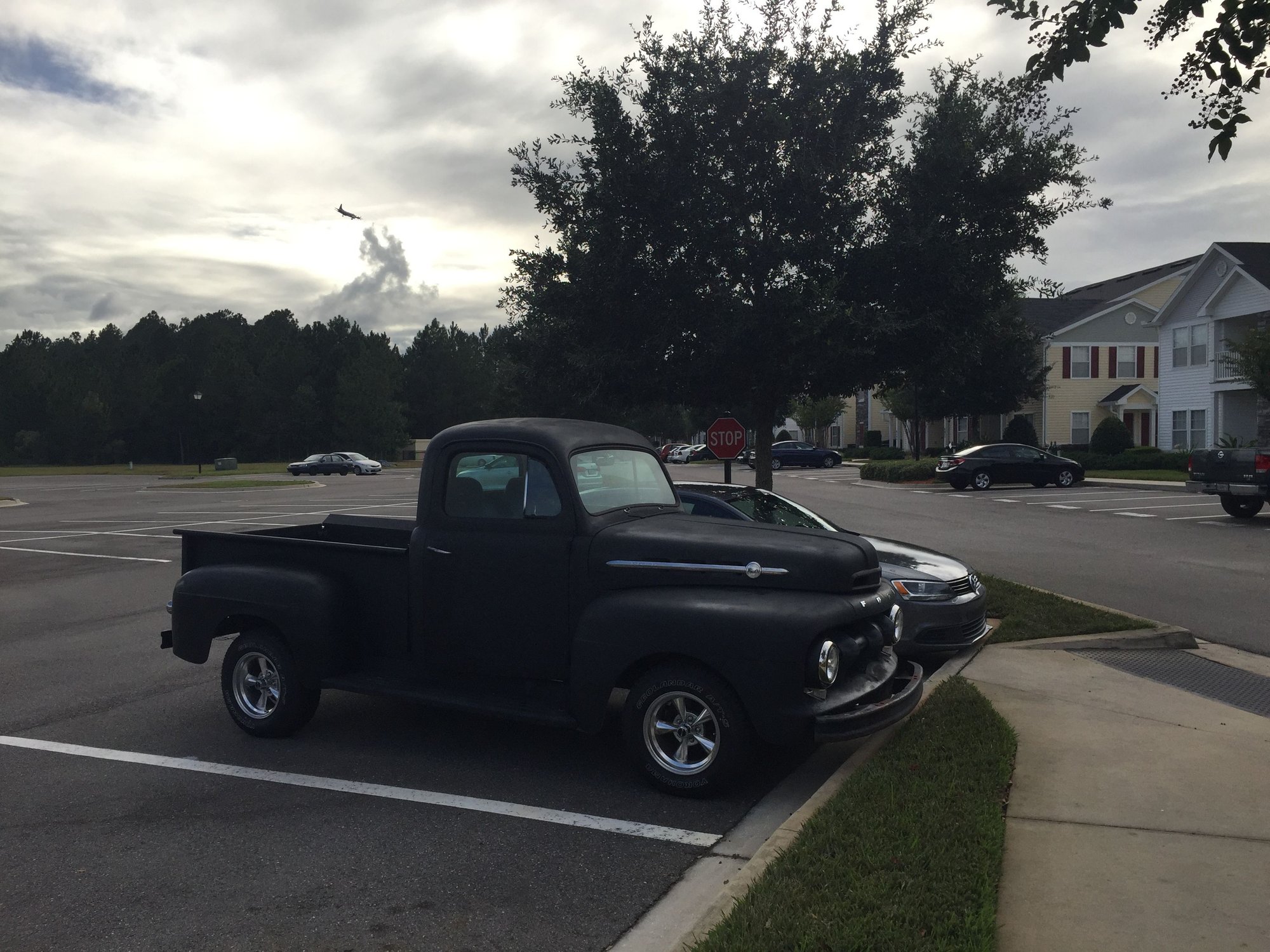

At stock height there should not be an issue. These are 235/75r15 in the rear. Being lowered, I can not run that size in the front. I tried & it rubbed a lot!

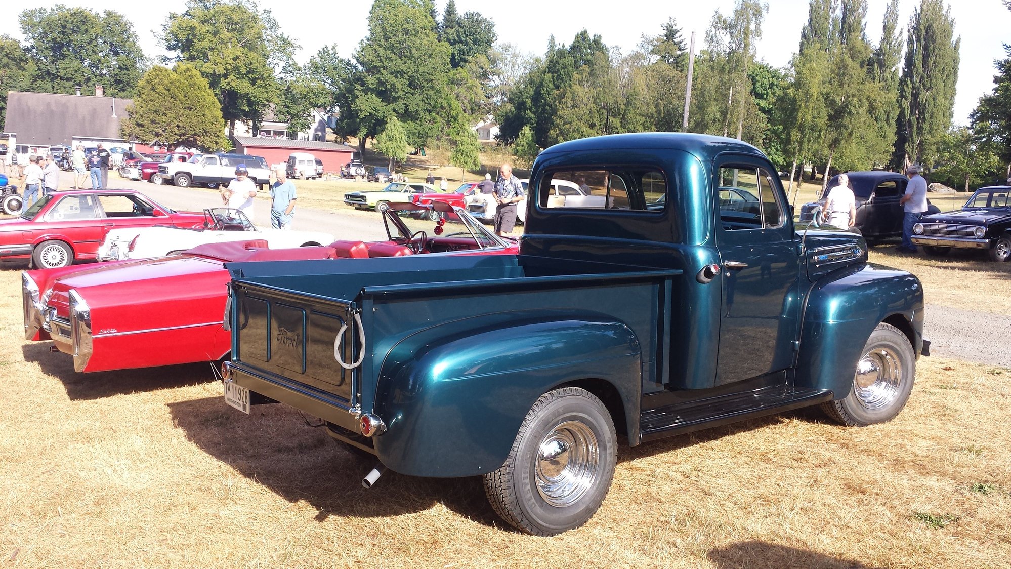

Here they are on a 52 that is stock except for a set of front lowering springs.
