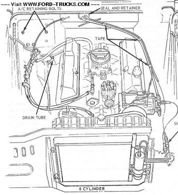

Where is that hose going to as it looks like it's going down in the picture and not back into the water pump. This is the lay out.
And if you have done the the carb base plate it just goes back into the return inlet on the pump.
The hose nipple on the intake manifold is the outlet and the pump nipple is the inlet.
Orich

Thanks for the digram Orich. It's hard to see in the pic but I do have it hooked up like in the diagram. The hose that is going down is my spliced in line to the block heater. Although I think now that I was supposed to splice it into the "water pump" hose and not the "nipple" hose.

The way you have the hoses routed looks ok out of the intake manifold and back into the block circulates the coolant.
