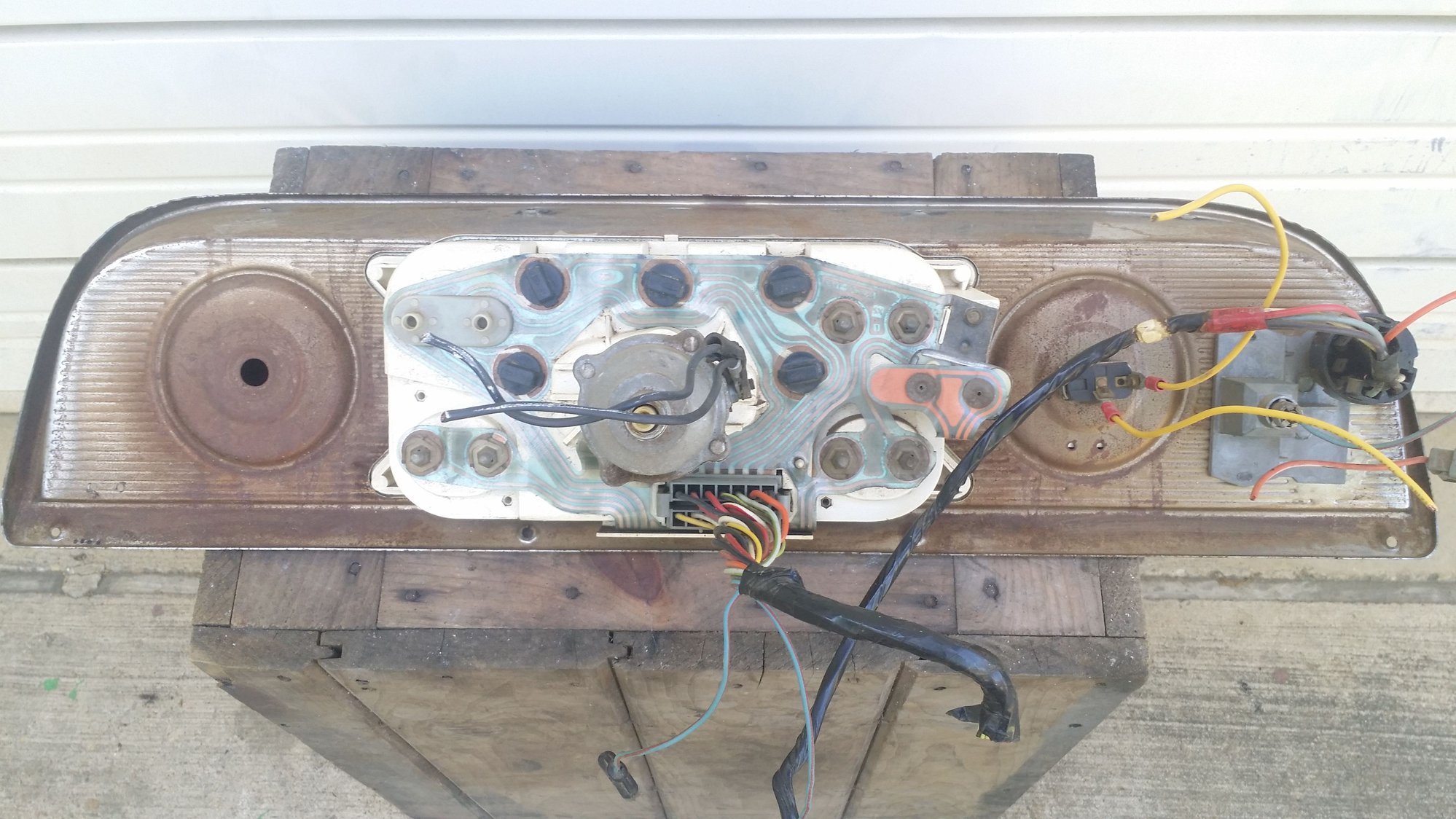

The Bumpside style (metal) dash structure carried over into the Dentside F500-up model big trucks. Dimensionally, a '73-'79 F500-up big truck instrument cluster will bolt right into the dash cluster opening of a '67-'72 F100 - F350 truck.
This is the latest model big truck instrument cluster I have --from a '78 F600. I'm fairly certain '77 and earlier F500-up clusters were hard-wired, just like '67-'69 F100-F350s.
Printed circuit.
This is the only Dentside F500-up cluster I have that has a printed circuit. All the other black/chrome Dentside big truck clusters I have have a hard-wired cluster.
