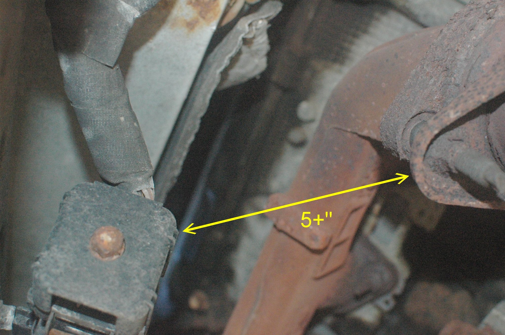

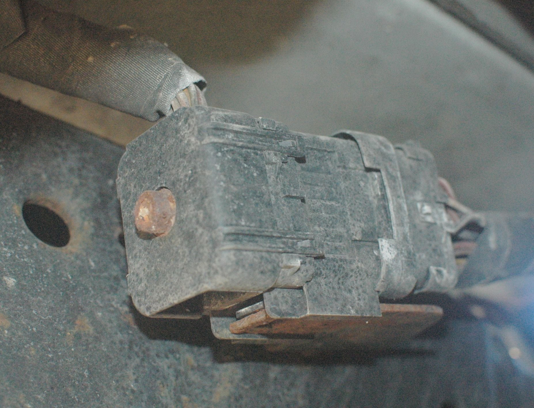

Originally Posted by motorcarmike
Its underneath, almost right below the driver's right foot on the inside of the frame rail. Right where the exhaust manifold flange is.
As soon as the sun comes up I'll crawl under my two E250's and see what's what.
This might be one of those things we all need to check periodically.

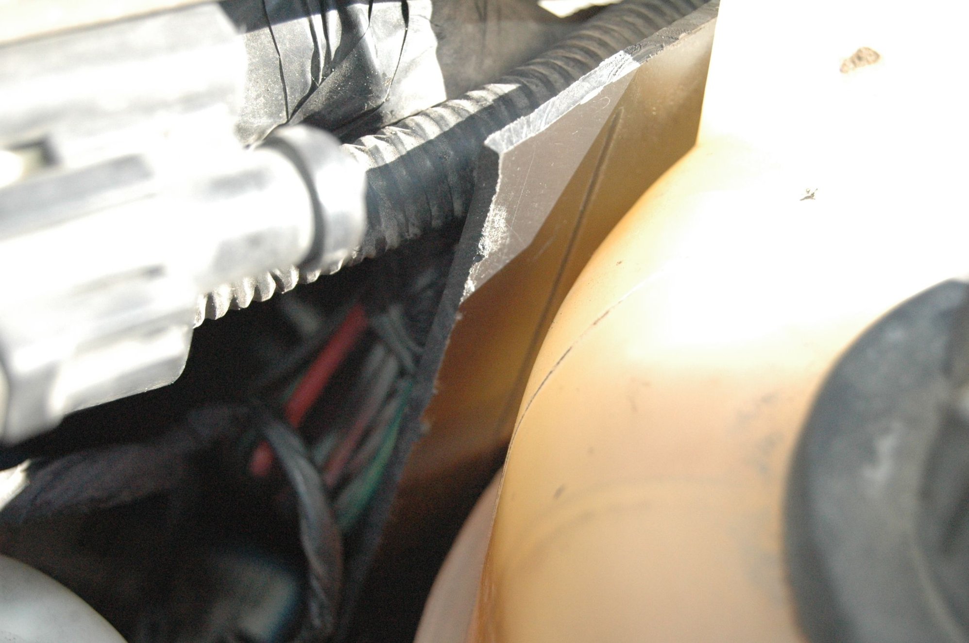

Update: So crawled under my E2fiddy's and both those bibs, skirts, aprons etc etc don't seem to have suffered that same fate. Between the rather large distance to the exhaust manifold and such plus the general nature or appearance of the connector unless something VERY wrong happened there's no real reason heat or high amp draw would cause what we're seeing.
If there are any signs of past exhaust work I'd chalk it up to someone getting a bit too close with a torch etc. I'll post a few photos shortly---I don't believe you have a lot to worry about at this point MCM.

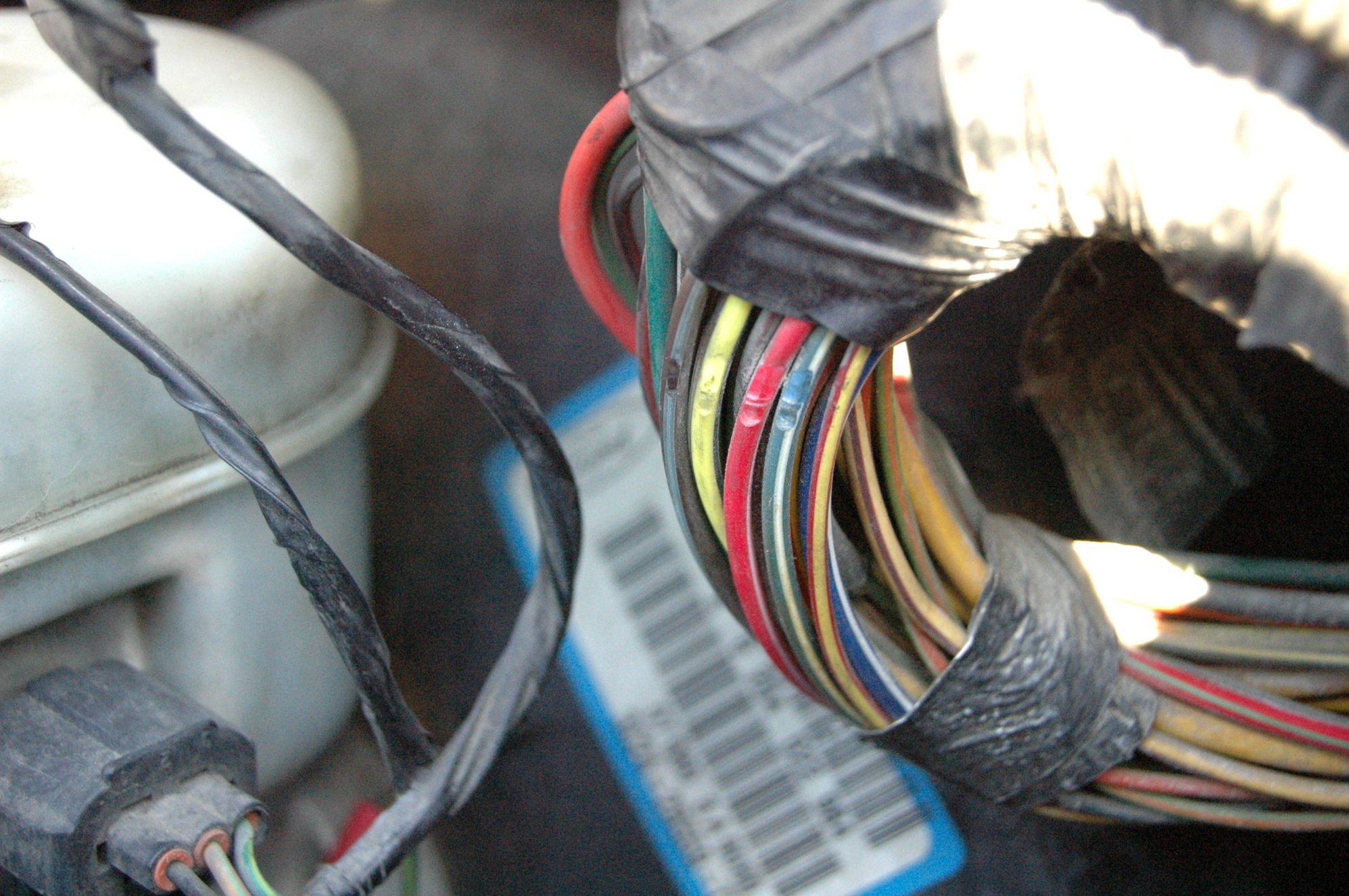

Now if you really wanna see something of slightly more concern---check this out:
That bundle is caught between the radiator overflow bottle and cowl panel. While not horribly chaffed or in danger of catastrophic failure its something to address. I did this as a temporary fix, still holding after a full year or so:
That's nothing more than a hunk of plastic between the installed and secured bottle and the wire bundle---better safe than sorry.
Anyway HTH.
