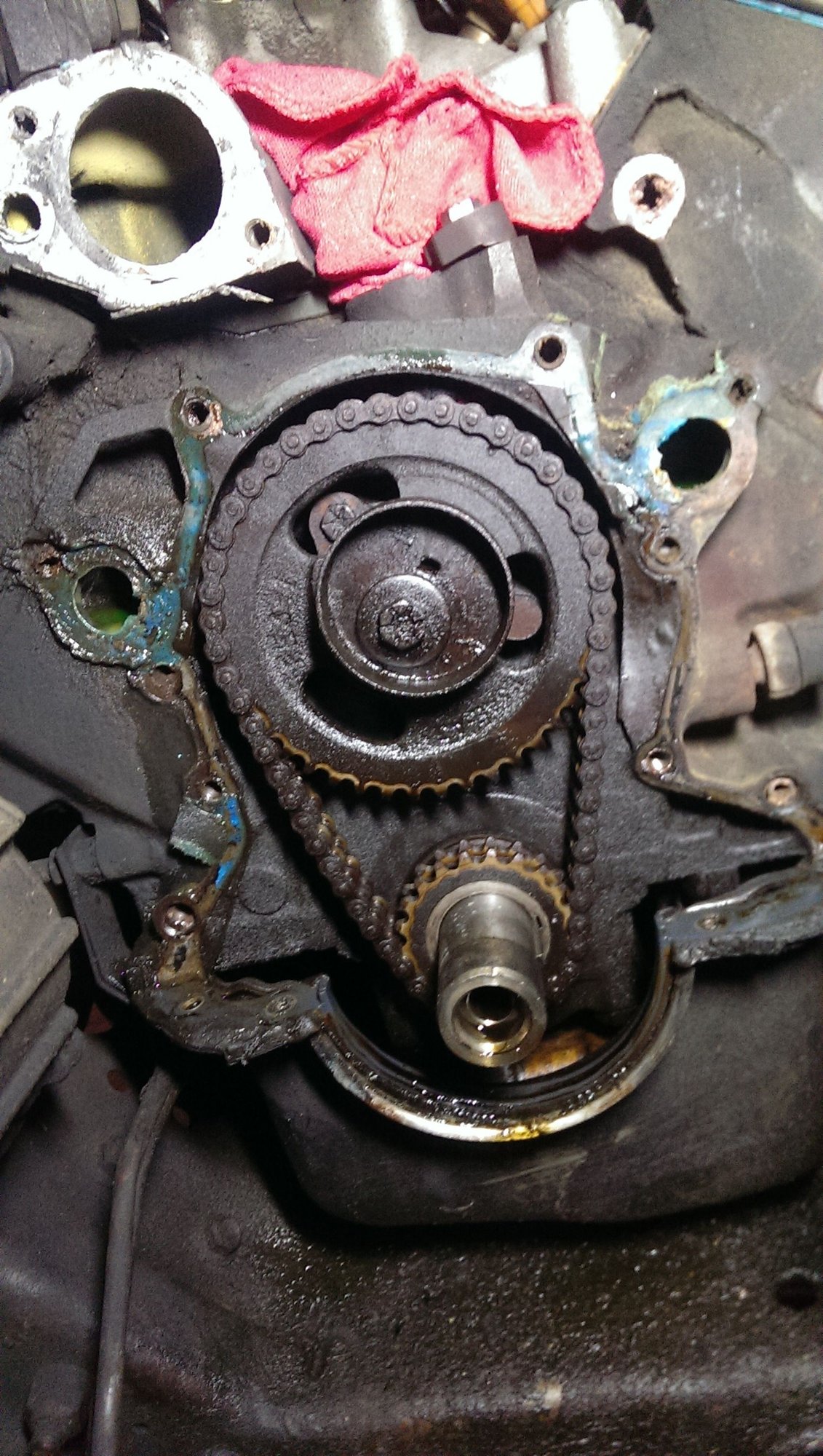

What's the eccentric spacer on the cam sprocket for?
88 302 EFI. Seems like it's for a mech fuel pump, has a Ford engineering part number (E8AE) on it.

Yes that is what it is for.
Its the eccentric cam for a mech fuel pump.

Yeap, your right.
Someone had already changed the timing chain and then added that. I've seen it before on a '89, 351 I tore down that someone added it.

I do not think someone added it. I think it came from the factory that way.

Maybe Ford did, but I've seen where the Felpro Gasket set includes the cam eccentric for the mechanical fuel pump. I just figured that whoever repaired or replaced the timing chain just added it cause it was included.
On his engine and the 351 I tore down, both have the blue Felpro gaskets. I know some one swapped sprockets on mine cuz they had different stampings than the other 302, 351's I have. And also they used plenty of that darn orange Gasket sealer!!

Figured.
Thought it may have been one of those hex-a-just kits.

Odd.
Engine was rebuilt with about 500 miles on it back in 88? 89? (The people who know that are now dead.) Ford did the job.
Not sure. Never seen one like this on an EFI truck. I'm the only person in the last 25 years to see this part. As stated above,, rebuilt at 500 miles by Ford reps from Michigan.

Not sure what year Ford quit putting them on from the factory but the 1989 Ford shop manual shows it for the 5.0L engine and the 1992 Ford shop manual does not show one. I do not have a 1990 & 1991 Ford shop manuals.
All of the 1988 & 1989 FI engines I have tore down did have one.

Just got done tearing down my 90 EFI 351 and yep mine had the eccentric also and my lifters are the same they are just stuck with years of gunk spray them down with cleaner and find something to grip them with and pull, it may take a bit but they will come out.

I worked for Ford back then and they were still putting the eccentric on because the engines that went into industrial and some marine applications were still carburetor engines so they just put it on all of them instead of trying to keep them seperated

That makes more sense.
