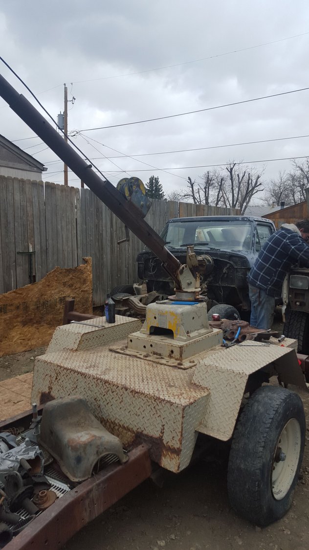

Tired of trying to use the cherry picker in the dirt time for the big boy toys.
My father-in-law had this nice little winch trailer to use and after an hour of fighting in the dirt trying to move the old big block we gave up and moved things around for the trailer to pick the engine and tranny with. BEST DECISION EVER. Has a nice extendable boom and the winch gearing you can't even feel the weight, plus the boom swivels so it will make picking the engine and tranny from the donor to the '76 a lot easier.

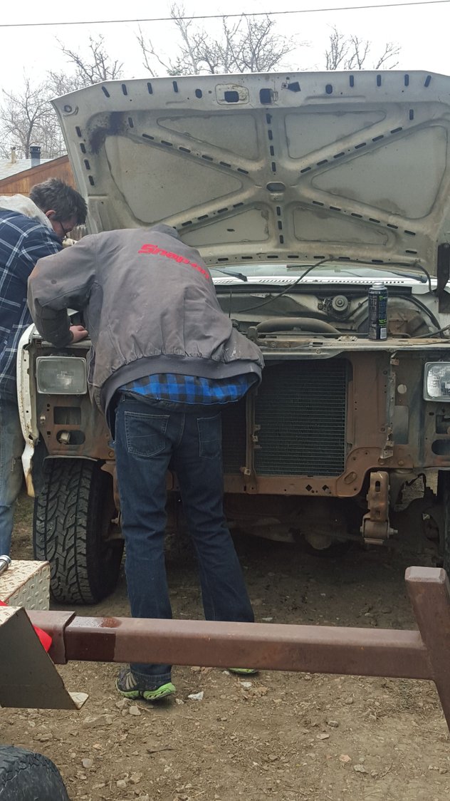

My nephew and father-in-law prepping the donor truck.
Before the weather shut us down for the day we did start on getting things removed from the donor truck so we can just pick and drop the other engine in place once we switch motor towers.

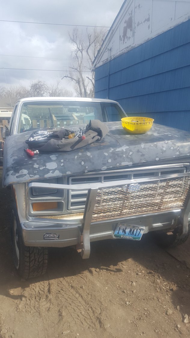

Donor engine, Ford 300 inline 6 and granny 4spd she ain't pretty but it runs and drives.
Nice big hole ready for the next piece.

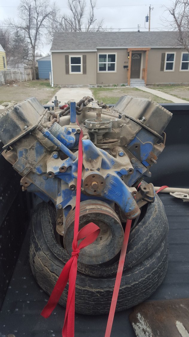

390 in the back of my truck ready to head back to the house to be tripped before going to the machine shop.
Loaded the old engine in my truck and took it home till I can start work on it.

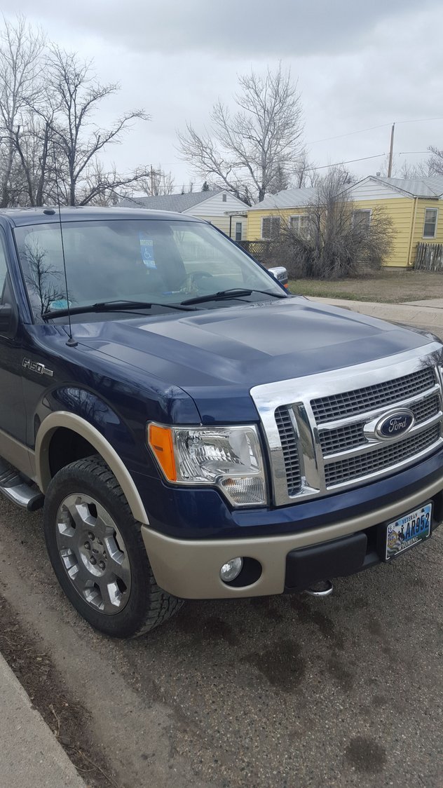

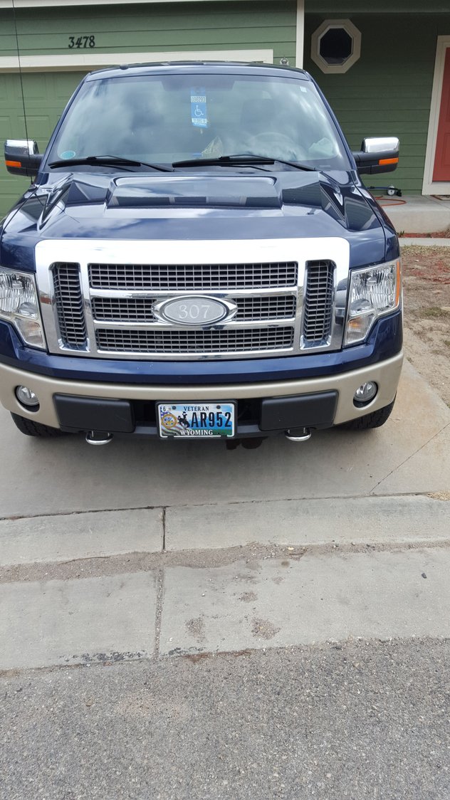

Decided since I had a bit of daylight and my house hadn't started snowing yet I would switch out the emblem to the cool area code emblem made by a friend of mine. I had read a lot of posts about how hard those are to take off. Yea one of the easiest things I have ever removed two little lock nuts knock the pins off and the darn thing falls off.
A little side project going to replace the front emblem.
Looks nice and shiny.
Close up of the new emblem.

Front clip off ad motor disconnected from the cab
Cap unbolted and rolled out of the way
Cab sitting in the bed of the truck.
