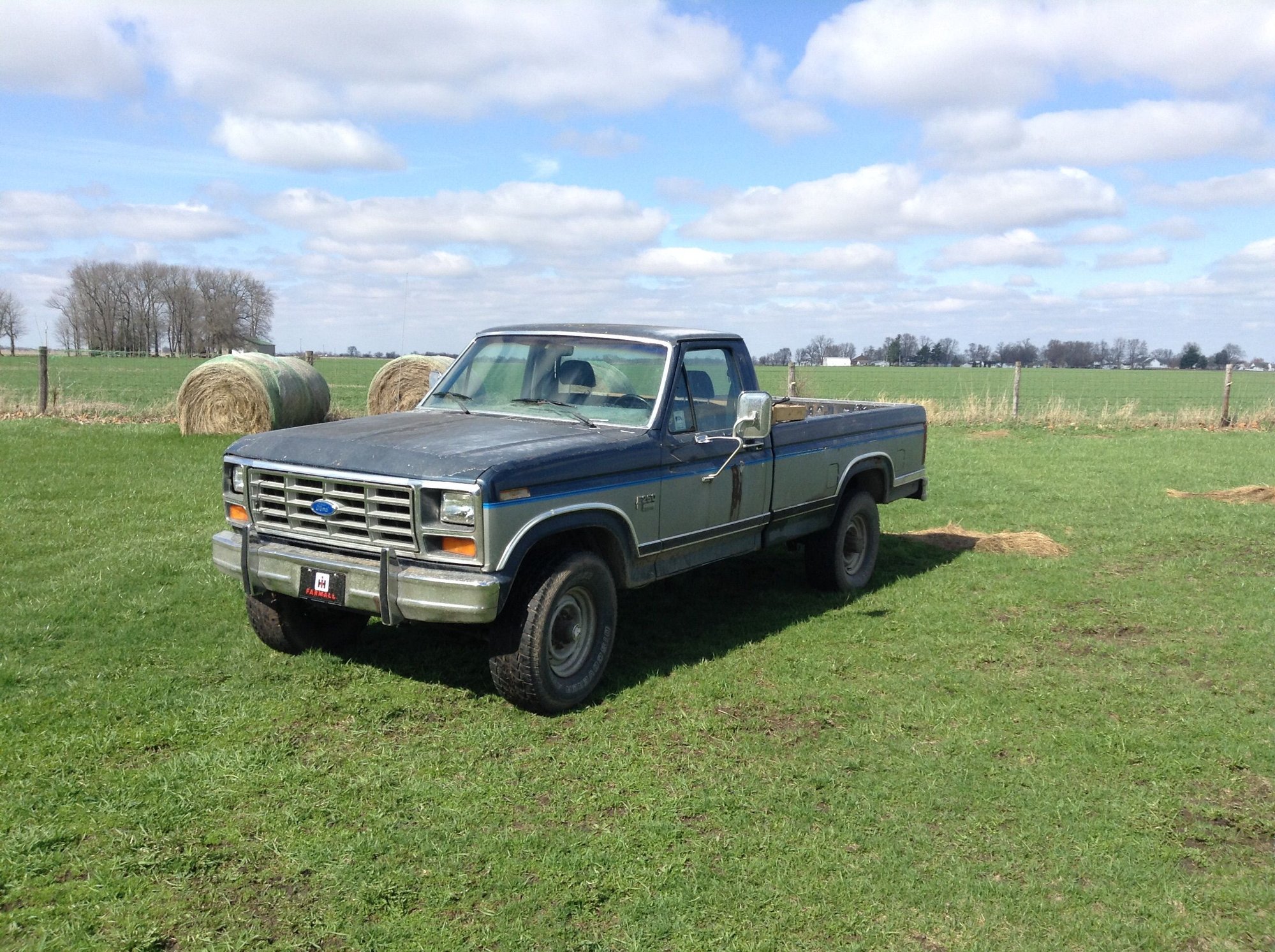

Thought I'd show you what it looks like

^^^^^ Wow, awesome sky. If the guy who painted this were alive today, and taking photos of trucks, he would take that pic.

Yea alotnof people make fun of Indiana but the sky here is quite beautiful it has great sunrises great sunsets and pretty blue
