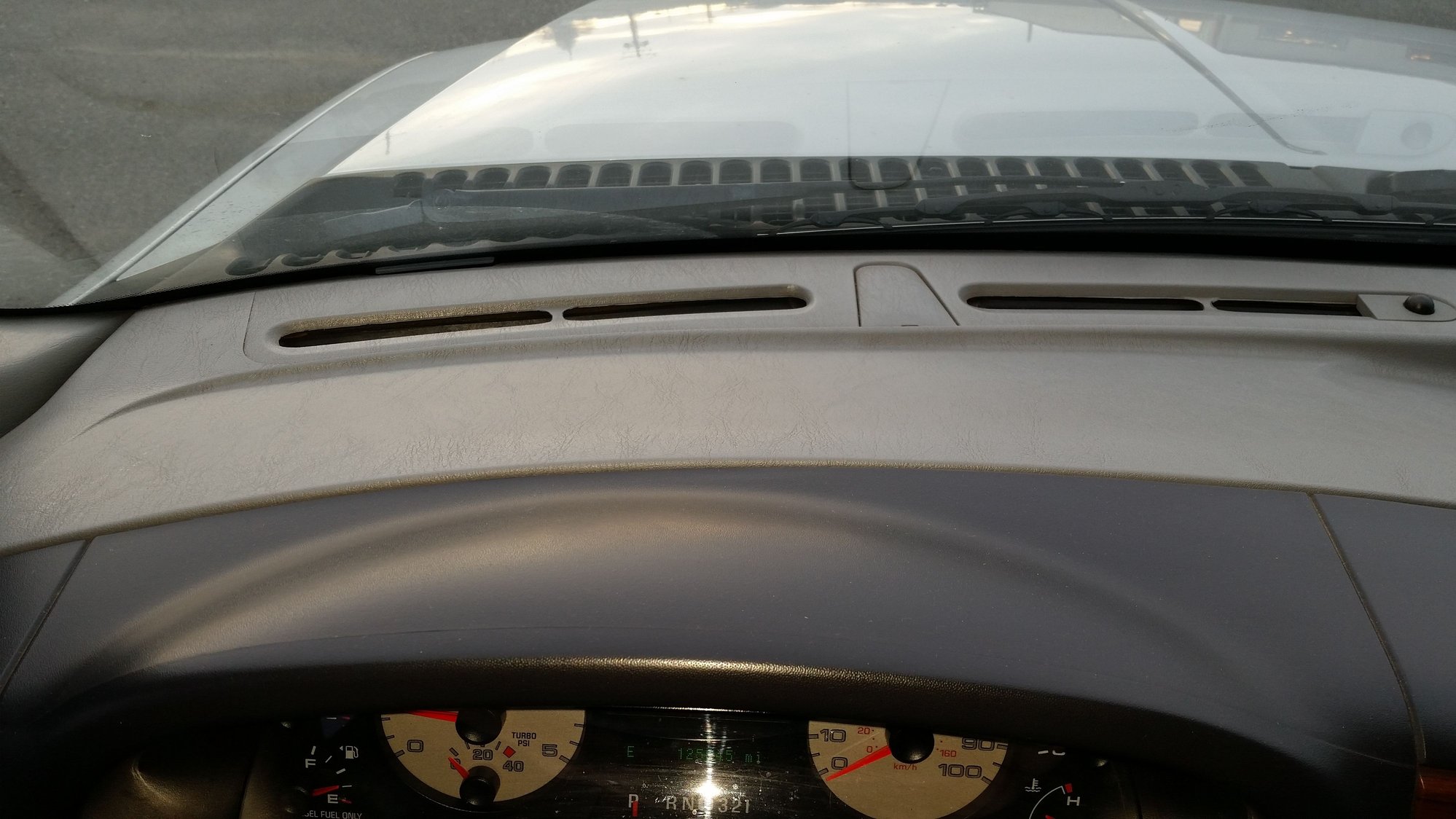

Camping Situation:
So, my wife and I have not purchased a trailer yet. We are planning on doing that this year late or next year. When we do purchase the trailer, I will plan on using a separate solar system that will be "A-framed" foldout style that I would hook up to the deep cycle batteries I will have for the trailer.
Truck Situation:
I want this panel on the truck to be just for the truck. My cover on the bed of the truck is a tri-fold soft top. I didn't have the money for a hard top. And like I said before I want this to all be hooked up to the truck batteries in a permanent style, no plugging in or un-plugging.
I guess the more and more I think about it, I am not so opposed to mounting the panel to the roof. But I would be worried about wind gusts while driving, and it would obviously have to be "Weather Proof" not "Weather Resistant"
Here is a a pic of the side of the dash area I was thinking (light gray area), because it also has more than a 15 degree angle, but I am just worried about the heat in the summer time with the windows rolled up, and the loss of efficiency because of the window.

So, doing more research and looking around I like this option the best, so far:
Roof Mounted:
SunForce Products Inc. - Trickle Chargers - 10 Watt Utility Solar Panel
Most power output without having to use a larger panel.
Seems once you go over 10 watts that the panels get long and narrow.
Also, if I were to go roof mounted, does that mean I can't go through the touch-less car wash I usually go to?

So, after reading the installation instructions on the 10 watt panel, it is glass that theamorphous solar cells are on. Also, I can't seem to find one for sale anywhere on the internet.
I have been "chewing" on the idea of using the dash with multiple panels as you have purposed. But I just don't think I can come to terms with having more than one on the dash. And the only ones that seem to look decent for maximum watts is the 2.5 watt.
