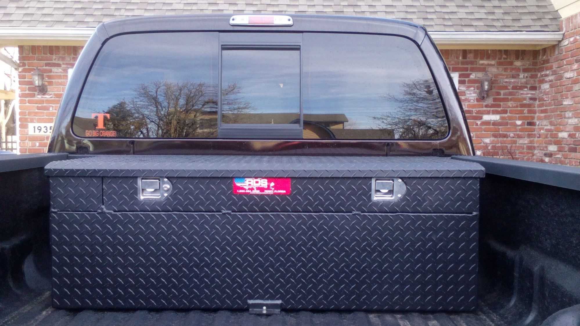

Well I picked it up today. It was everything I expected. I wasn't going to fool with it until tomorrow but about 5:30 I couldn't not install it. So about 2 hours later its all hooked up. I just put some temporary bolts through the holes to hold it in place. I went to Lowes after I had everything else done and got all stainless nuts, bolts, and washers to finish it up tomorrow. I filled the truck up and then put 5 gallons in the bed tank. I didn't open the valve yet. I took a few pics but I was working in the dark for the most part. I will update tomorrow when it is completely finished.

I finished up the install today. I filled up the factory tank after I got it all tied in. I had a small leak in the connection nearest the fuel cap. I moved the clamp and tightened them all again and it seems to have stopped. I put 15 gallons in the bed tank and opened the valve. The tank looks good to me and I am happy with it.

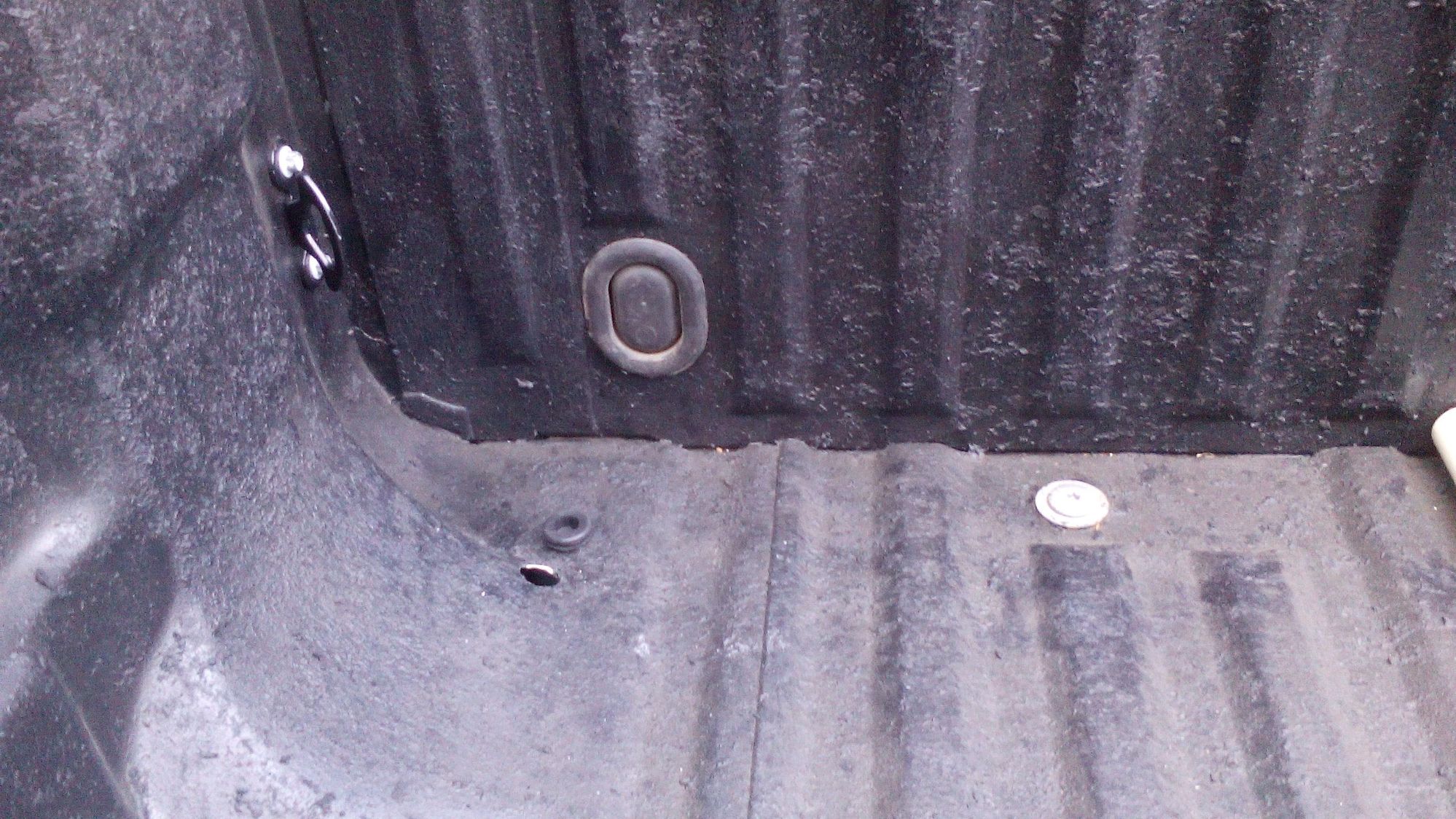

This is the first hole I drilled. The 7/8" bit worked perfect with the 1 1/8"od-5/8" id grommet from Lowes.

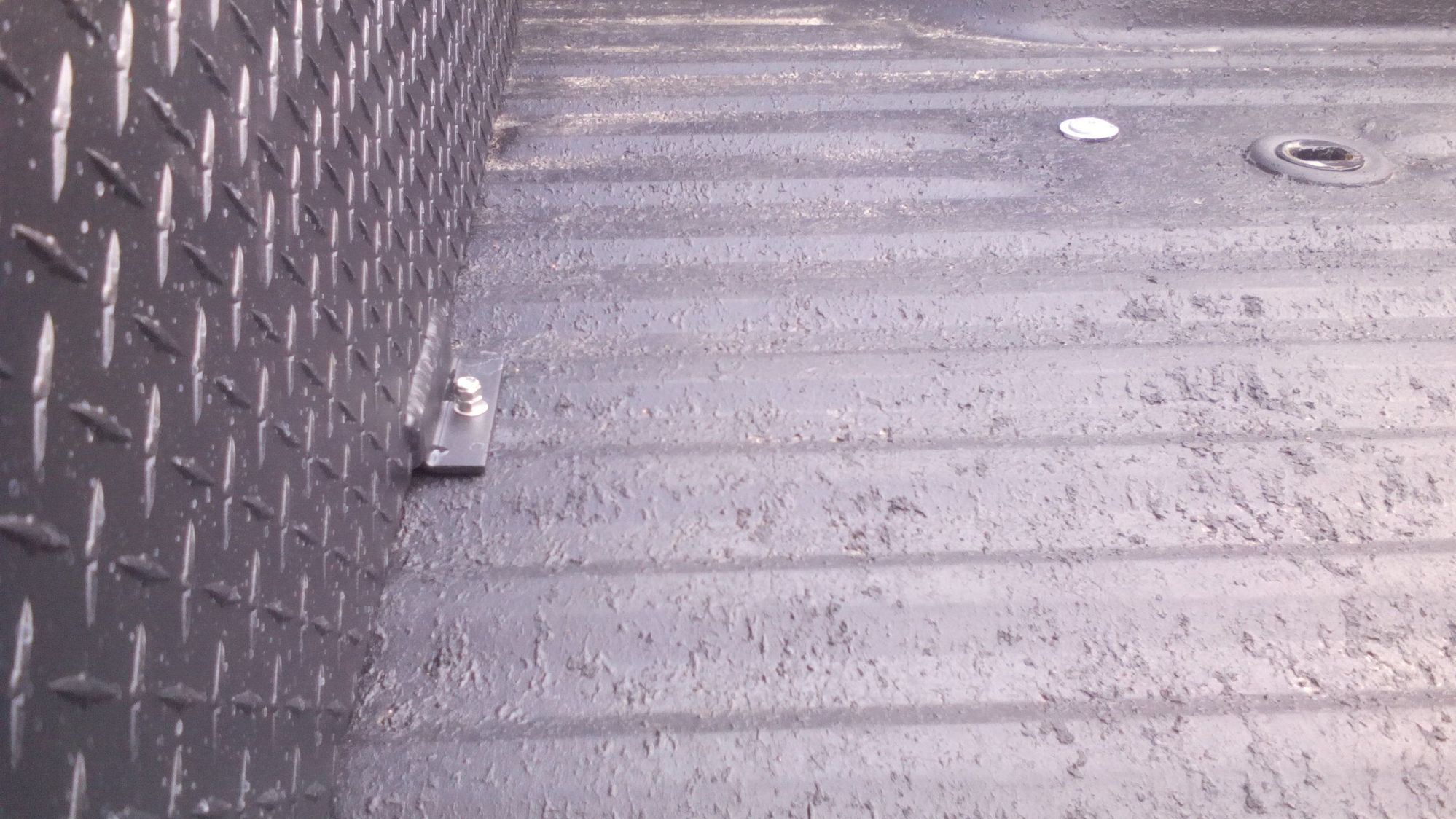

There was no way to get a nut and washer on the middle tab from under the truck so I had to feed the bolt up from the bottom and put the nuts on top. I don't like it but it was the only way to get it done.
I like how it blends into the bed. The finish is almost the same color as my bedliner. It is just a little lower than the bed. In the dark you can't tell it's in the truck until you get right up on it.
