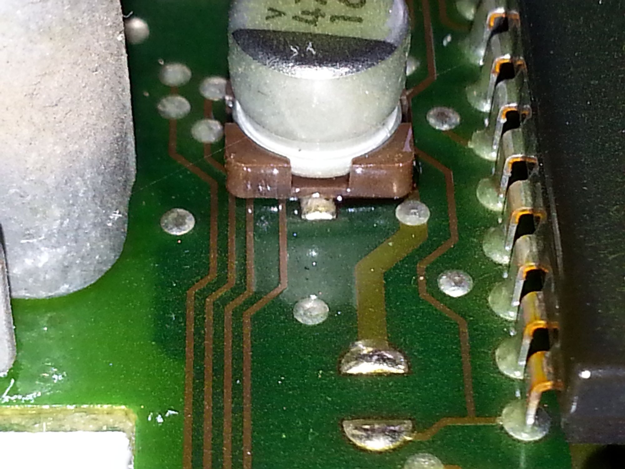

Thanks Timbersteel for the reply I took very close pics of said caps.
Here's a close pic.
And a very close pic

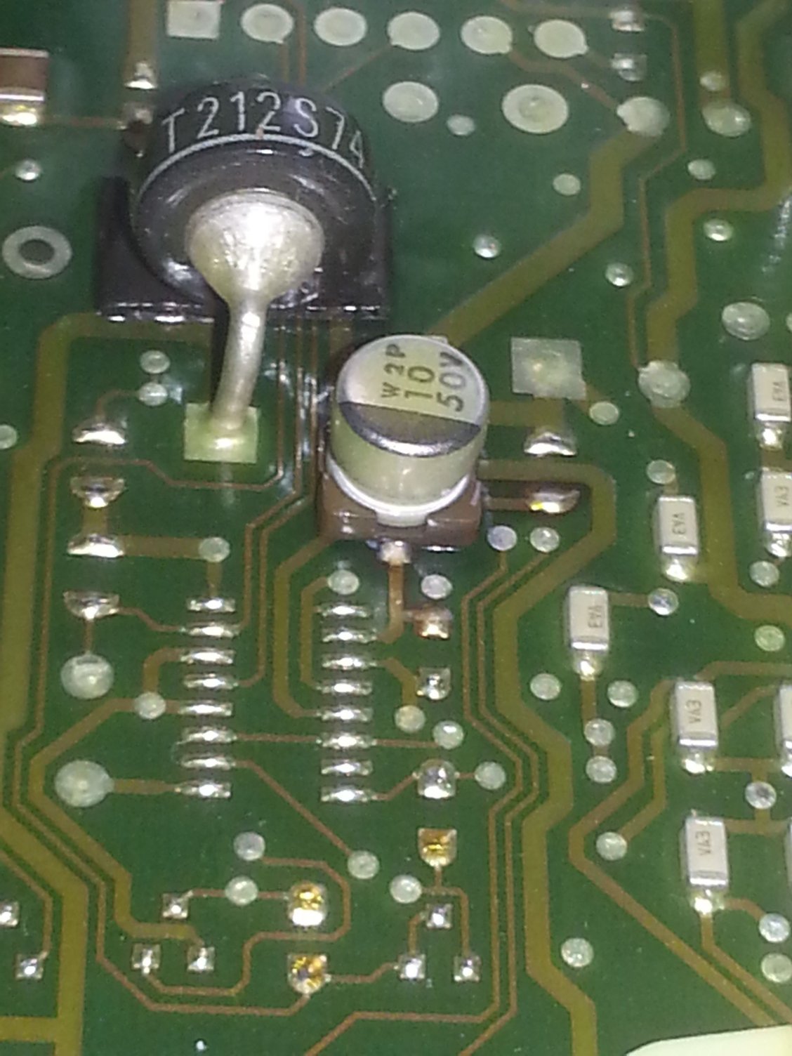

Here's the second cap
Old Mar 5, 2016 | 01:55 PM

The 1st and second picture of the same capacitor shows a likely problem.
The 2 traces are brown from perhaps excessive voltage or heat. Is there any liquid residue around the base of either cap? If there is ANY, that cap(s) are dead. Being a solid can capacitor, they won't show obvious signs as their lower counterparts of bulging or leaking. I would question that capacitor in the 1st picture.

No liquid at all. Do you or anyone know what ohms those caps are?
Old Mar 5, 2016 | 02:03 PM
timbersteel's Avatar
timbersteel
Joined: Mar 2005
Posts: 4,698
Likes: 47
From: Mexico, Missouri
You can't Ohm out those capacitors. They are rated in Microfarads. You would need a capacitance meter or a way of checking their capacitance.
But with the age of them, it's only a matter of time when they fail, not if.
Hopefully others will chime in for help.
I'm unsure of the resilience of solid can capacitors.
My only concern is the capacitor with the adjacent traces being dark brown from either over voltage or heat.
