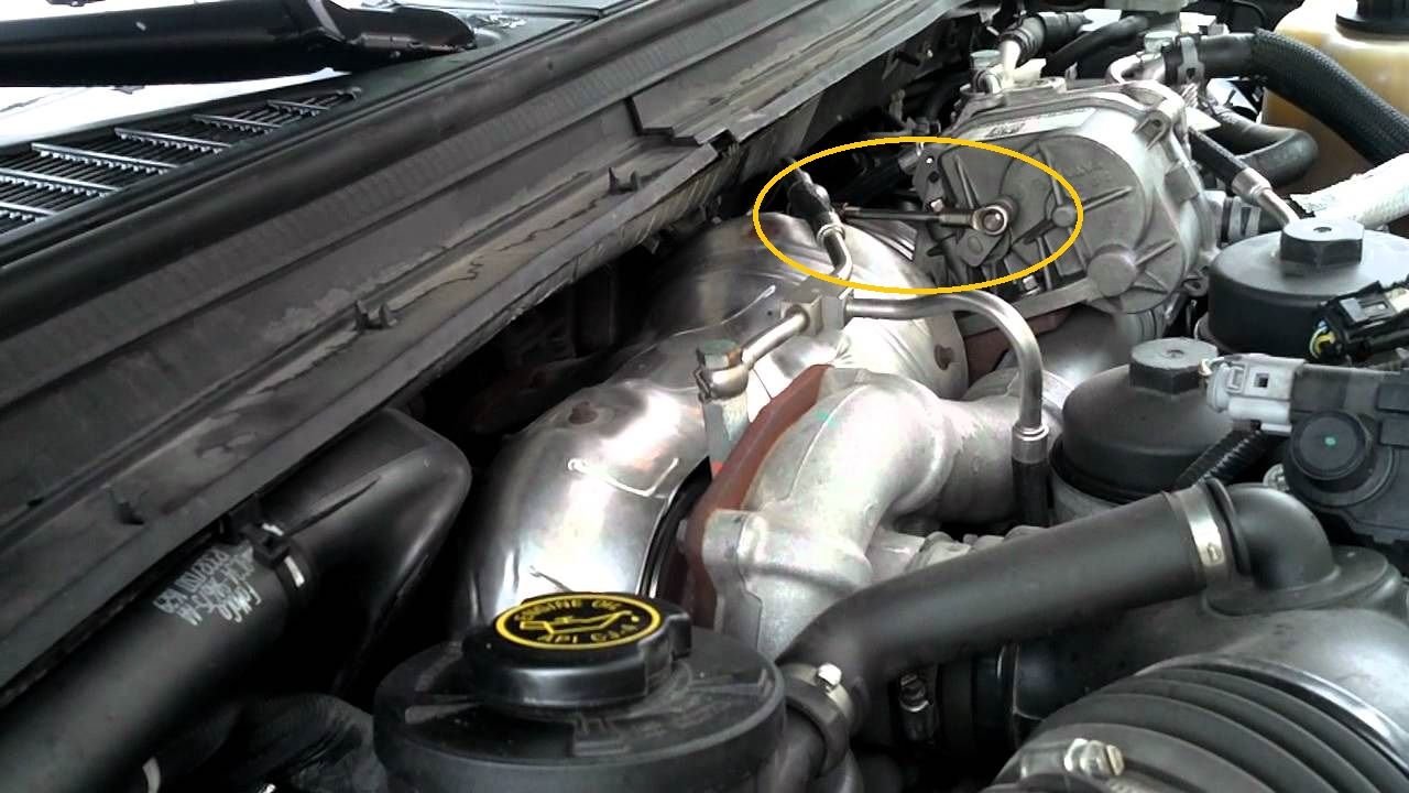

Sounds like the actuator mechanism could be binding? try to move it by hand with the key off. it should move freely, without binding, but it does have some weight to it, so it will take a slight force to get it moving. Does that make sense?

Start with the connector... I have seen a few that just flat our had chaffed wires and just changing the pigtail solved the problem. After that its kinda difficult to diag without an ids... But, when you turn the key to run (don't crank it) does that actuator arm cycle. You will physically see it (you will need someone to watch it from the front of the truck) move. If it does not you have either a failure within the actuator, electrical, or stuck veins.
If it does move then you probably have a sticking turbo. It is very uncommon for stock trucks to have sticking turbos because of the regen cycle. The heat cycles keep those veins clear of carbon buildup. But deleted trucks that don't get driven hard will have the same problems that a 6.0 does. The veins can rust or coke up causing this dtc to set. On a 6.4 it means turbo replacement.
If you get past checking wires and movement of the actuator you will need an ids or equivalent scan tool unfortunately. However, its about 15 min of diag for a reputable shop to get to the bottom.
Side note, exhaust leaks can fool the pcm into thinking the veins aren't actuating properly. Generally it will catch it and set other codes due to incorrect readings from sensors, or you will see it with your monitor. But, it can happen. Again, when doing a boost test with an ids a tech will see this.
