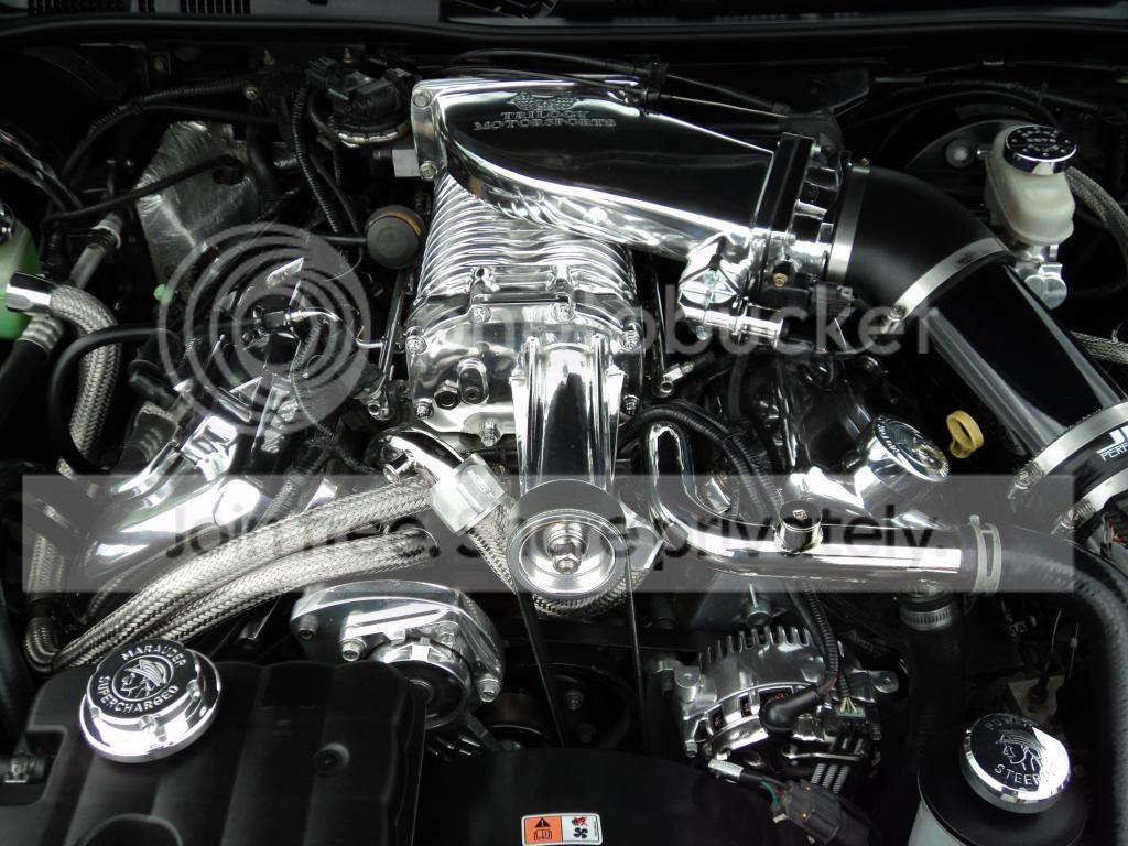

I am a lucky guy. I have a V10 KB kit....only 95% complete though. Haven't installed it yet.
What I can tell you is the kit uses the oem upper intake manifold. A aluminum lower is supplied as I guess the plastic oem one caused some type of issue.
The KB is attached with a 2 piece adapter. I would think a 5.4 kit could work if oem intake was part of kit.
Electronics would be wrong so custom tuning would be needed....just like me.

The entire blower housing sits on the lower. Not exactly the most rigid nor robust material for the job by itself, let alone with many more atmospheres getting pumped through it

On my V10 KB kit the adapter and blower bolt to the upper manifold, after the throttle body plenum is removed. In place of the plenum, if you are saying the 2 pieces left are both lower intake manifolds than KB instructions name the parts wrong.
