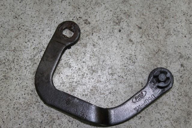

I was installing the kick down cable kit made by Lokar today and the kickdown lever that should be indexed at approximately 5 o'clock position is actually closer to the 3 o'clock position. I contacted Lokar about it but they said they have never run into this problem before. I was wondering if anyone else has run into this problem and if so what did you do to correct it ?
In this picture the trans cable bracket isn't tightened up yet but if tension were to be put on the cable it wouldn't rotate the lever at all.

Cable should be at a 90 degree angle to the arm...I haven't run into to that sort of problem before but it definitely is a problem to be resolved.

I'm going to see if I can make another lever tomorrow from the Ford piece I removed, I don't have much choice in the matter. I guess nothing is supposed to go smooth with these projects...

This is the stock piece that was on the transmission and what I was going to use as my solution to the fix, when flipped the opposite way it was originally installed it lined up perfect with the cable sleeve. I intended to drill a hole 1/8" diameter for the inner cable but this is the hardest material I've come across and a drill bit will hardly scratch the surface.
So I used it as a pattern and cut out another from 1/8" plate drilled my 1/8" hole
Then bent the tab. Will get another pic of it installed this afternoon.

Here it is installed and looking much better,,
