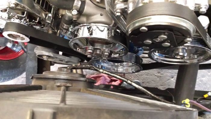

Interesting question and one that I recently asked of the rep from V/A myself. Here is a photo of the belt on my 351W engine showing the belt and numbers on it. As it turns out, there is a standard practice for numbering serpentine belts...the "6PK" means that this belt has 6 ribs. The "1525" means that the belt is 1,525 MM in length. So using this info I can go to any manufacturer/parts store and buy a 6PK1525 belt and it will work on my V/A Frontrunner setup. The nice thing about this is that if I should change something in this front accessory package that may change the length of the serpentine belt, say a different alternator pulley size, I can measure the length of the new belt needed and buy that belt by making up the new part number.

I contacted March Performance and they make the parts right here in the USA (big plus) and it's all bolt on, so I'll likely go for them. I'll have an extra alternator (boss version), but I'm OK with that. I maybe able to sell it for close to what I paid.
That's some good info on the belts too!
