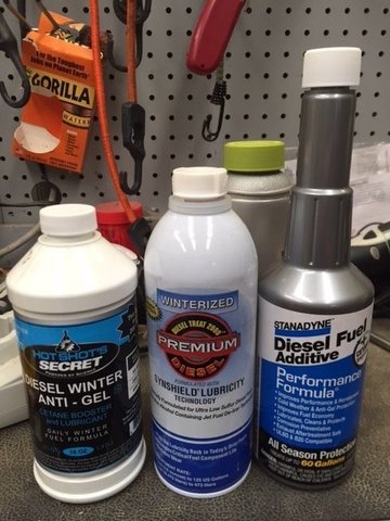

plus one of these in the fuel to prevent gelling.......but the trick with any fuel additive is to get it in the fuel before the fuel starts to cloud (@ 20 degrees F). They do a good job at preventing the wax crystals from forming but can't reverse the process. If you can't get any then add some #1 diesel in the tank.

All 3 in the photo above have the cetane boost as well.
