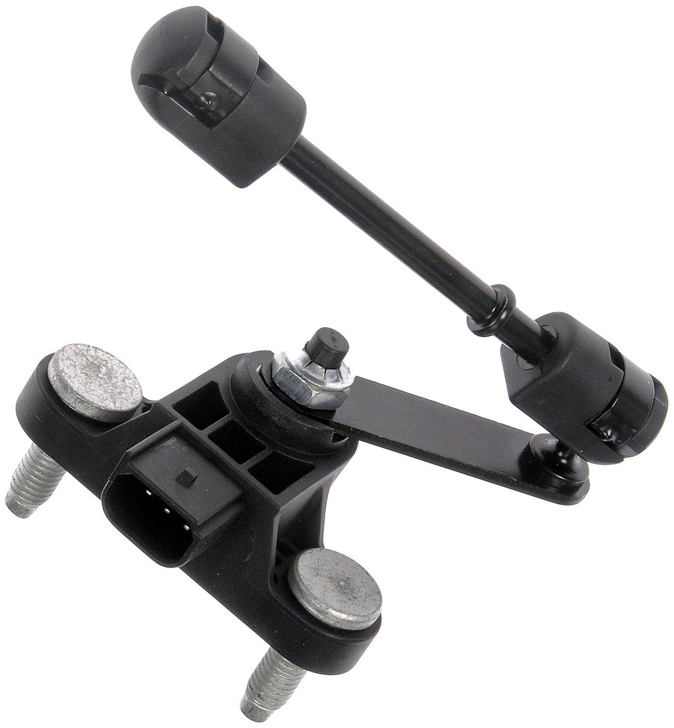

On my 2004 Navigator when the check suspension light came on it was due to the height sensor. I am going though that issue as we speak.
Check to make sure none of the height sensor linkage arms came off. The sensors are located behind in the wheel well attach to the upper control arm.
If your truck is sitting low and close to the wheel wells it may have bottomed out your sensor and it will not engage the compressor. With the truck running take a jack behind you front tire on the main frame of the body and jack it up a bit see if the compressor starts. If it starts go and look at your display without opening the door and the check suspension indication is now off.
This is what the sensor looks like.
