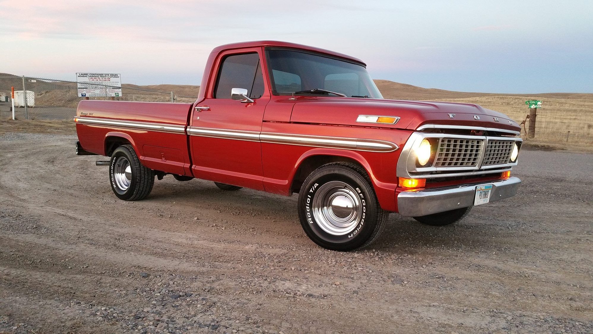

My '70 LB is lowered 3" and 5" and wears Wheel Vintiques Series 62 steel wheels.
Front tires are 225/70-15s on 15x7 with 4-inch BS. Rears are 275/60-15s on 15x8 with 4-inch BS.
Pics: https://www.ford-trucks.com/forums/1...l#post15260665

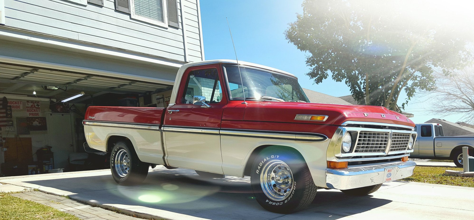

welcome to the site.....I just ordered some Wheels Vintiques like HIO has on his LWB, he actually helped me out alot when I was in your situation. I still have not put them on yet, but I ordered 15x7 front with 235/60/15 and 15x8 rear with the 275/60/15's I already have on now......here's my 1970 SWB, just lowered it 4' rear/3'front with DJM kit, just need to put the new wheels and front tires on. I painted them gloss black.
