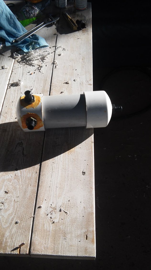

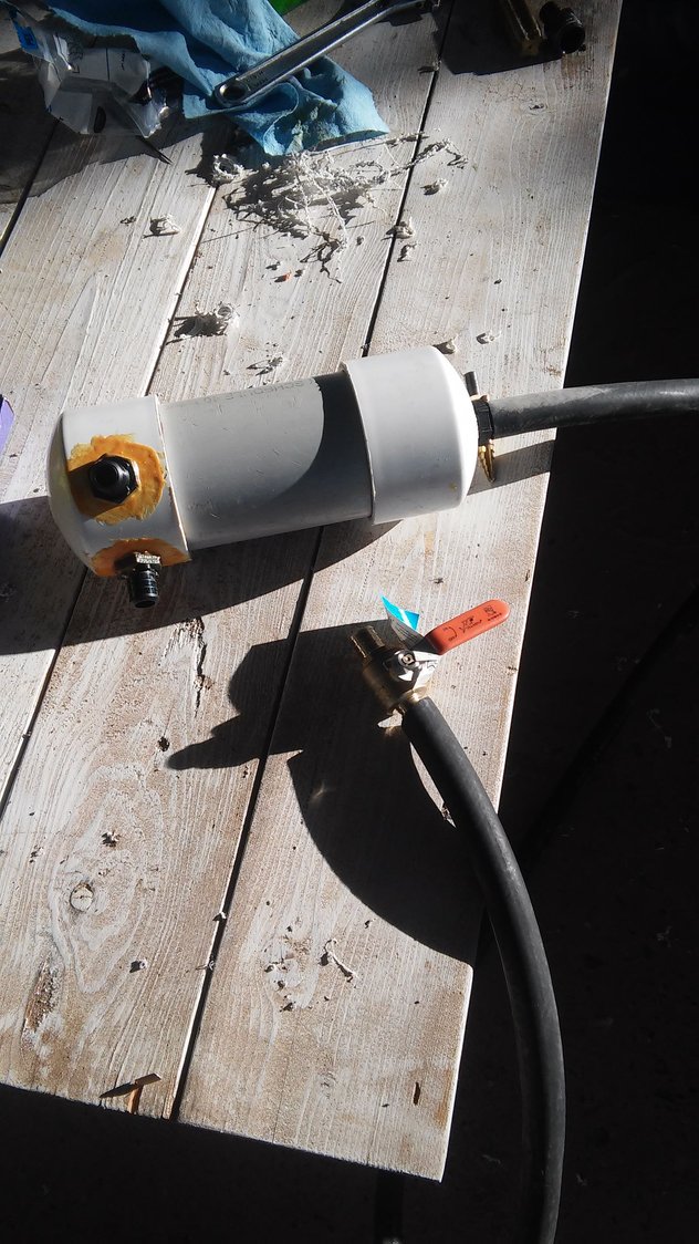

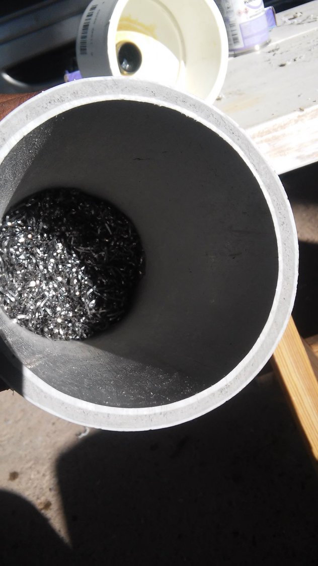

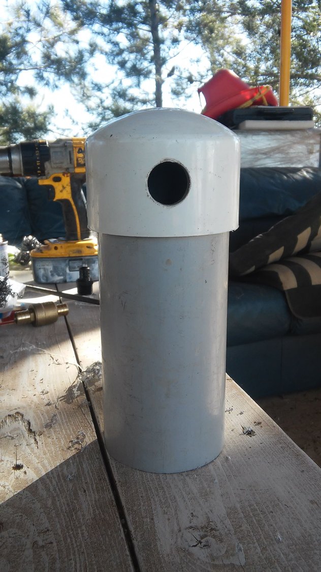

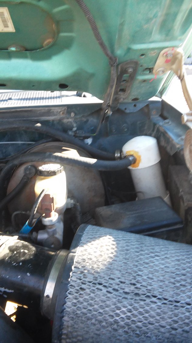

Just finish building one from scratch, and enough to store at least 1.5 qts of oil
Heres what I used, the 3" pipe end caps, the primer, cement, and brillo I had laying around heres what I used,

Looks like it will work!

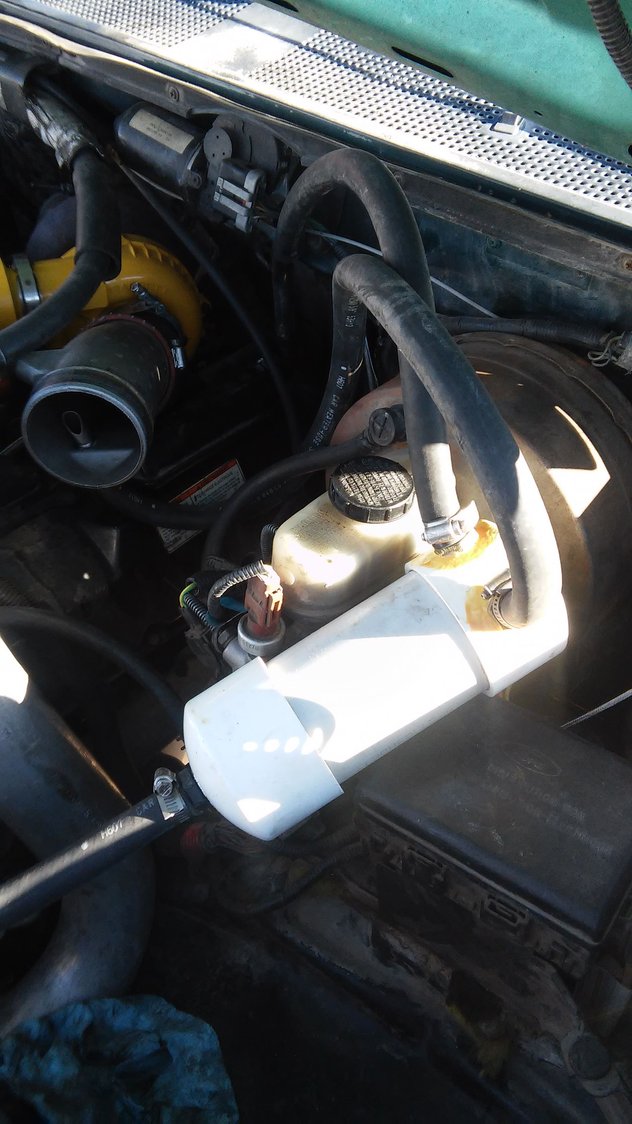

Its on the Mule, and time will tell if it works.
I didn't paint it maybe when ever I install the new engine here some pics.

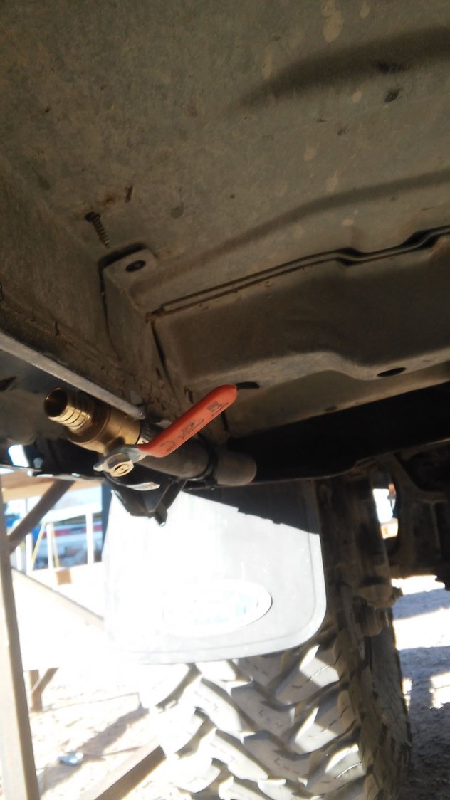

I routed the drain hose thru the inner wheel well down to the door
I used 5/8" coolant hoses, I can always change to 3/4". Hopefully theres not alot of back pressure

Well it works, this is only 7 miles of drive time, and 1hr idleing, I open the valve.
