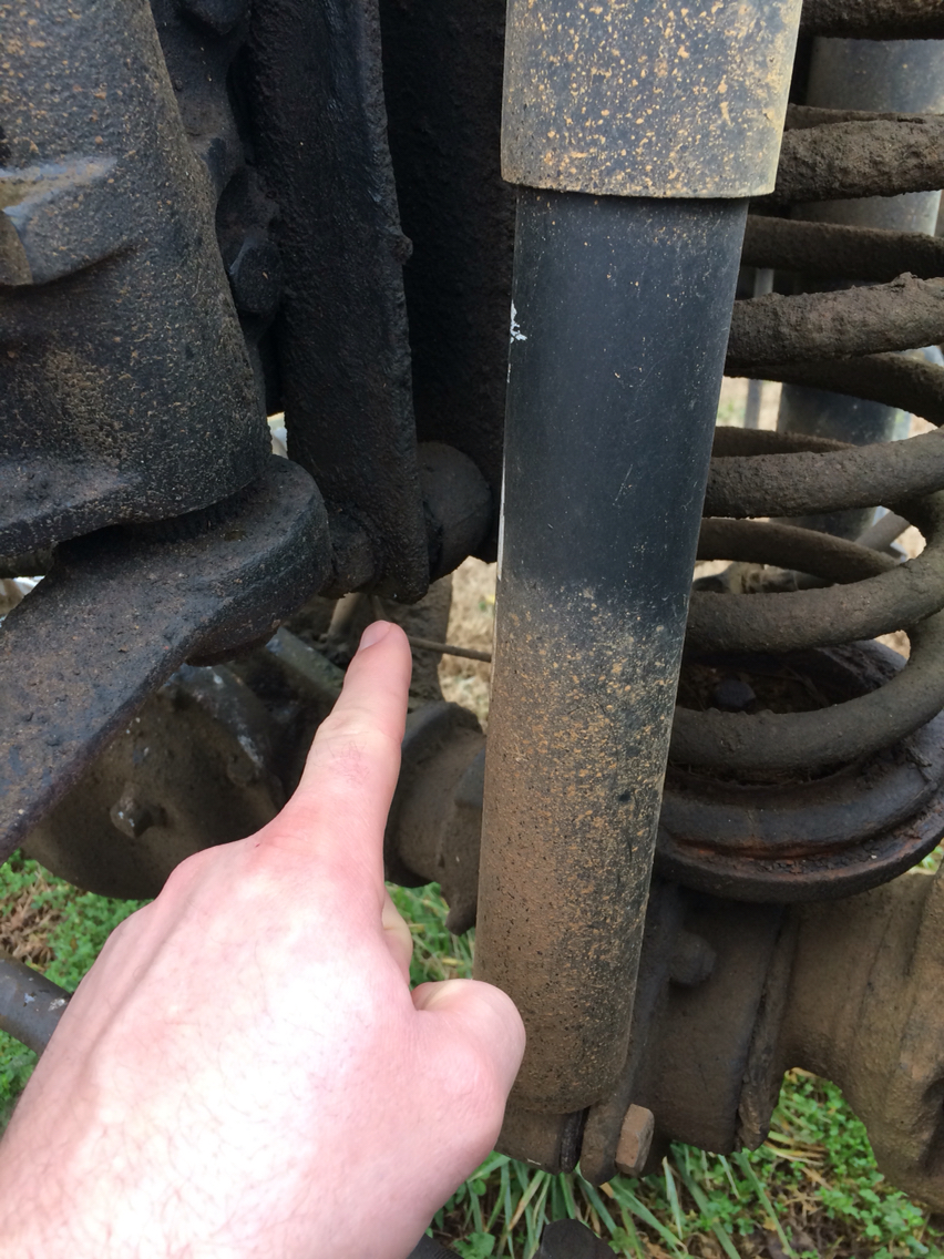

First question, that '79 frame, is the track bar attached to the lower part of the driver's side shock mount? Can you please snap a closer pic of that and post? I got the front sub section of a '78 bronco and it looks like they had a James Duff after market type track bar mount.

Yes, the trac bar mounts to the bottom of shock mount. I will try to remember to take some pics tomorrow.

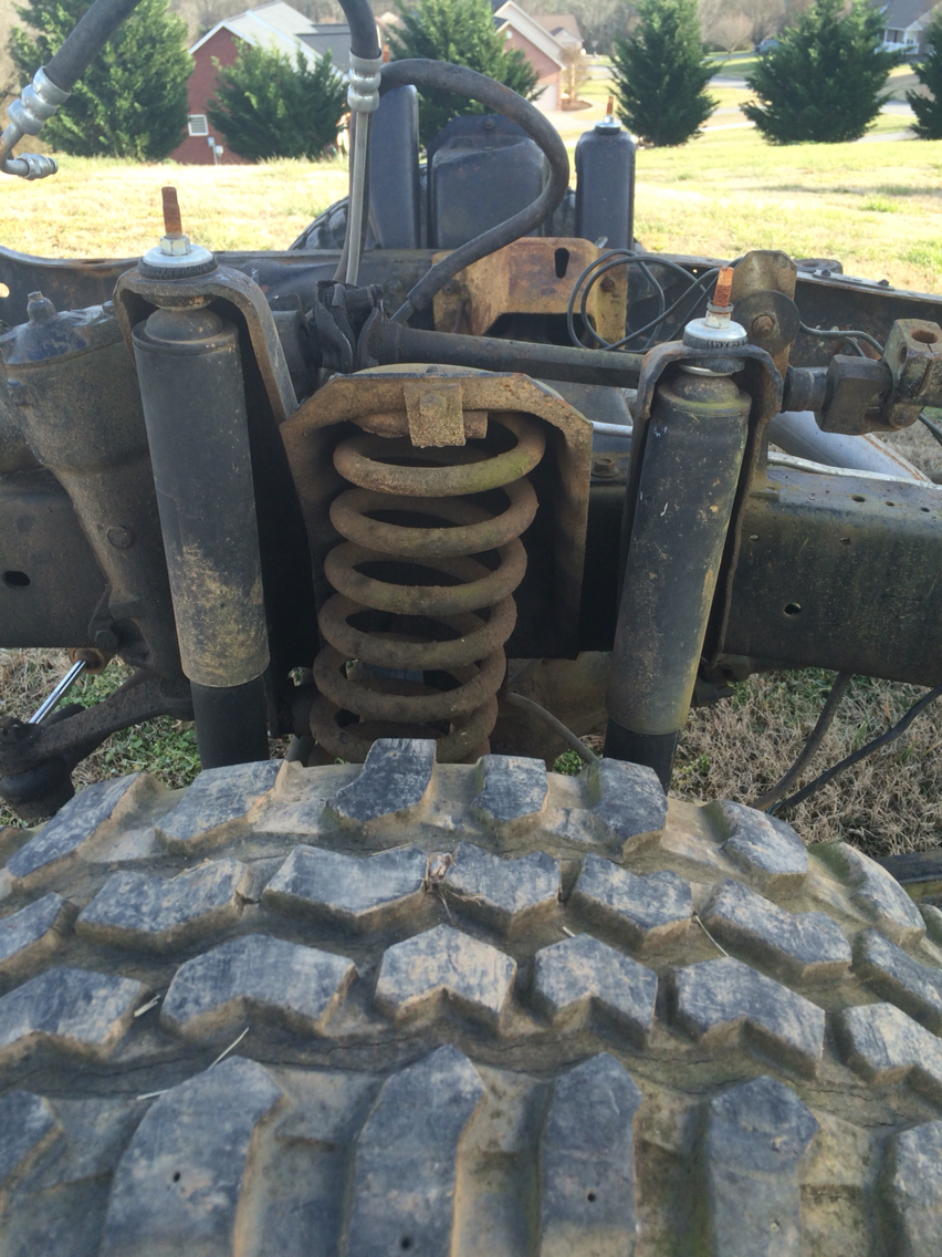

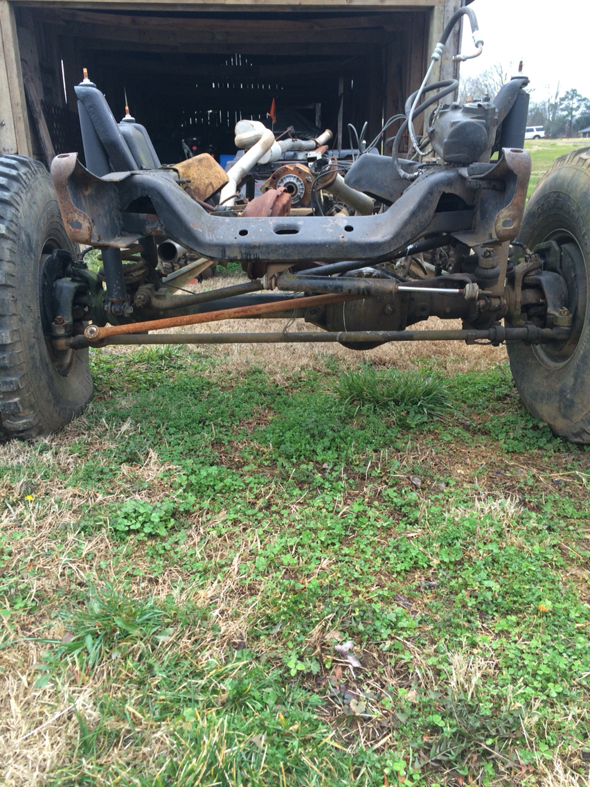

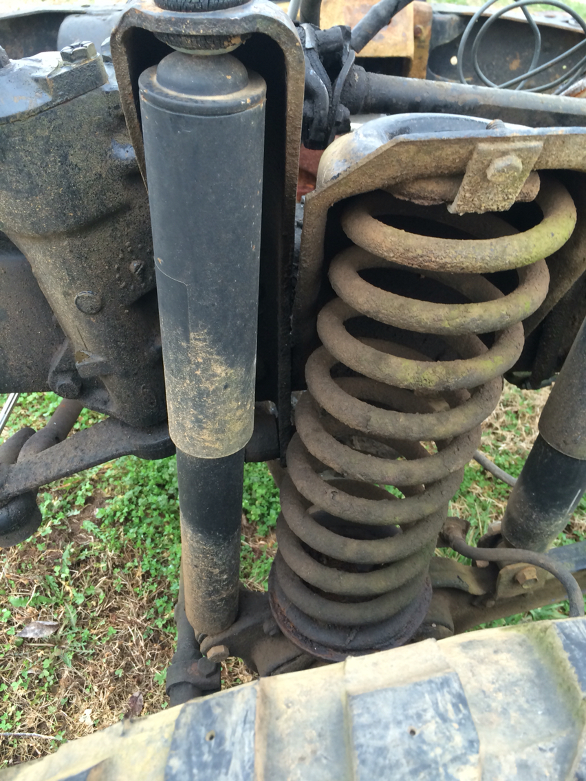

I got to looking at your pic on the '79 frame. Your shocks are infront of the axle where as the clip I bought had them mopunted on the rear. I would be interested to see your shock mounts as well. It would be odd to do but with a set of your shock mounts and my factory '78 mounts you could run double shocks. Wouldn't be a typical set up but doable.

My set up has dual shocks. If you had a 2wd zf5, you have the option of a divorced np205.Name:  photo544.jpg

My set up has dual shocks. If you had a 2wd zf5, you have the option of a divorced np205.Attachment 137976Attachment 137974Attachment 137973Attachment 137977Attachment 137972Attachment 137975
Ron, thanks for the pics. Would be nice to find a set of those radius arm caps to put a set of dual shocks on my rig.

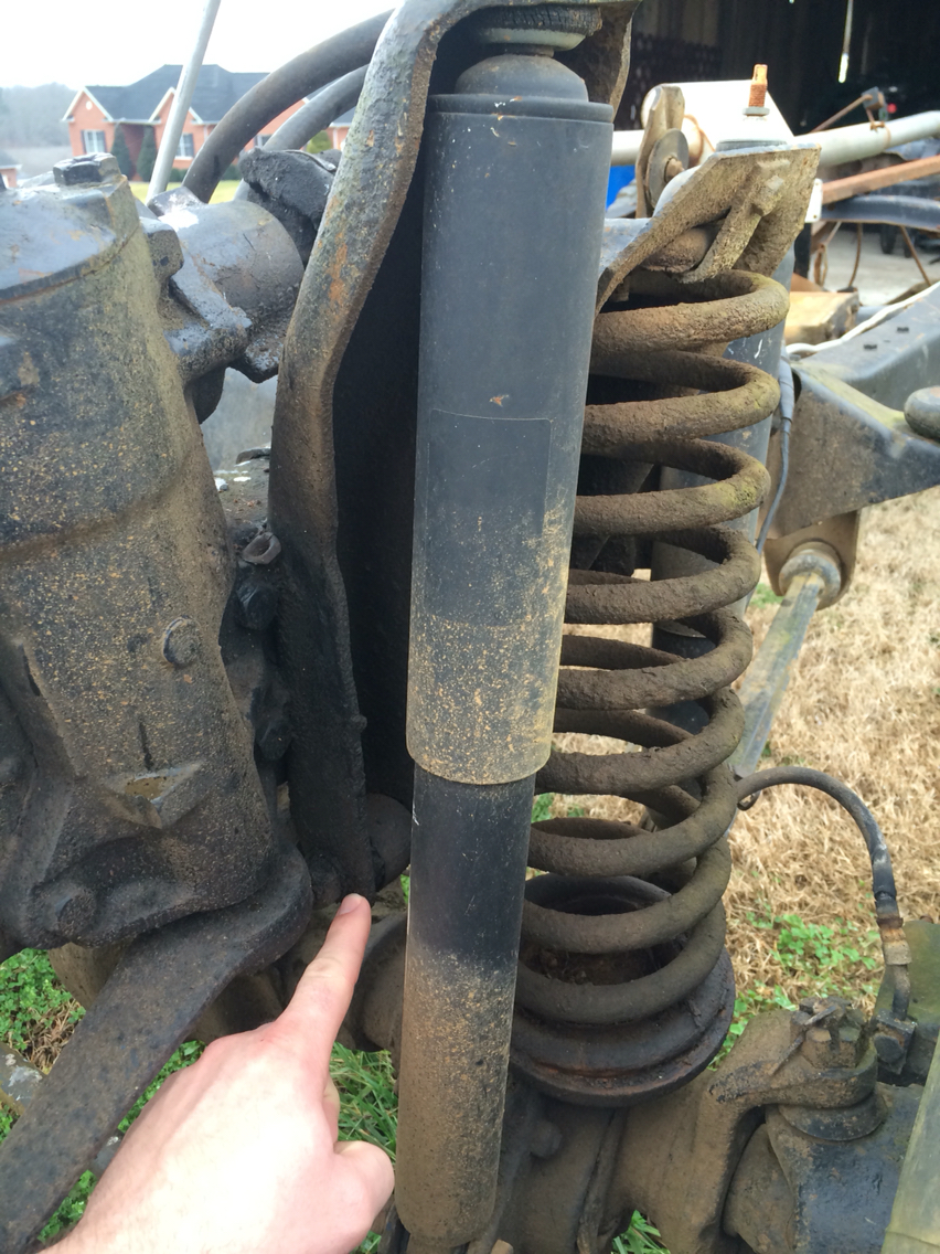

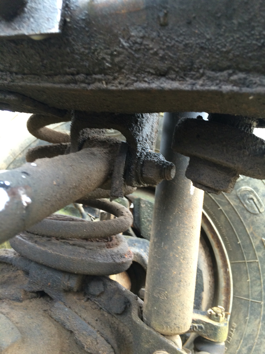

Btw, you don't want to run your trac bar to the outside of the frame like these trucks. Our gear box is mounted inside the frame, and your track bar will be a lot longer than your drag link.

Not exactly sure what your saying? I bought an adjustable on from James Duff. I figured I would use the bracket I got and adapt it like what most others have done which if I remember right would go below the frame and have extra bracing.

Your good to go then. Just don't want to use the shock tower as the trac bar mount like this factory set up. You see can see what I'm talking about in the pictures where I'm pointing.
