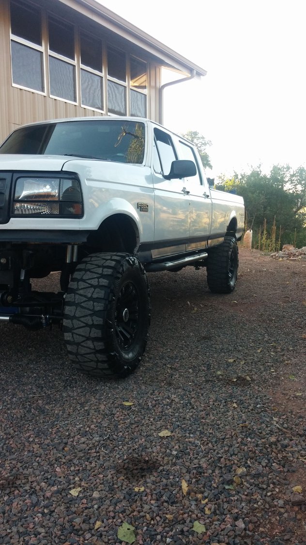

97 f350 pmf 4.5" w/37's
I used the PMF 4.5" with X codes springs track bar, dual steering stabilizer dual shocks up front. In the rear i used 6" springs. I was able to run 37's . I really like all the components and really like the way it handles and rides, I drive this truck up and down the mountains/foothills of Colorado loaded and unloaded, handles great. I still have a ton of plans for this truck just saving the coin
Great looking truck. Where did you get the smoked corner lens?
