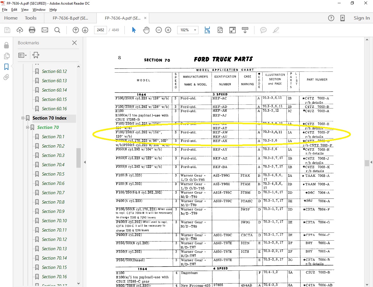

Hey guys I've been trying to get my truck going again and I'm running out of luck. I can't find a main shaft or input shaft anywhere. The tag on the side reads HEF AU. Does anyone know where I could locate these parts? Or if any of you have a spare 3 speed that would match I would be interested in purchasing it if the internals are good. Thanks in advance

I see a good number of two possible input shafts available NOS.
Do you have the 1964-1972 Master Parts Catalog or how are you going about searching? The HEF-AU is covered by parts list 1A as you can see on this page within the yellow circle.
Attachment 136692
I was calling around to local places and searching on google but came up empty. How can I purchase this part?
I could really recommend the Master Parts Catalog so you can do your own research. The next thing to determine on the input shaft is if it has 25 helical teeth or 24 helical teeth. Two part numbers. Check your current input shaft and depending on how many teeth you can see the part numbers. Then go plug those numbers in on Rearcounter.com

I can tell from combining those two charts above that yours should be the 24 helical tooth variety so this should be your link. Verify before you buy if you can, though.
C4TZ-7017-B | RearCounter.com | 5 found at 3 sellers
I've dealt with all 3 of those vendors - each more than once - and they are all good.
As far as Mainshaft. Look at this picture and see if you can say what shaft you are referring to. I only see a Countershaft (7111) and the Countershaft Cluster Gear (7113), an Output shaft (7061) and the Reverse Idler Gear Shaft (7140) and the Reverse Idler Gear and Bushing (7141) but see what base part numbers you can see and I'll go from there.
