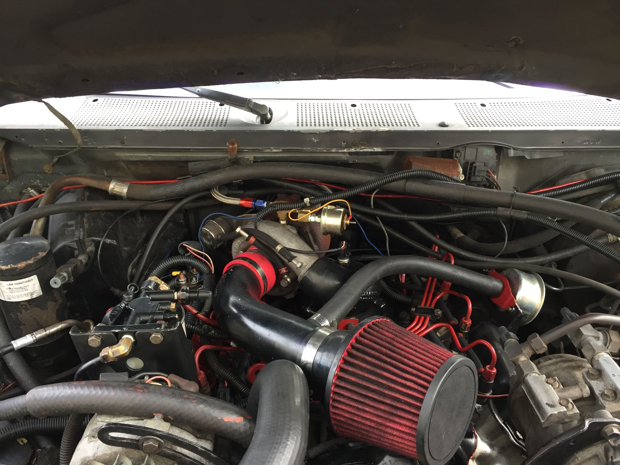

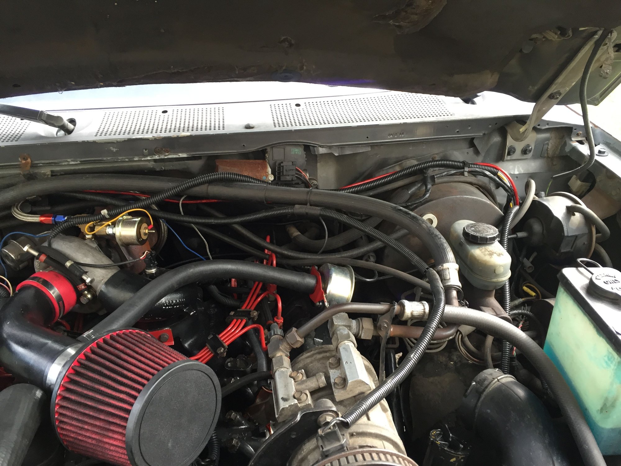

rebuild of my 88 IDI pics
mostly stock
-R&D stage 1 cam
-ATS 093 turbo w/ Wicked Wheel2
-910 valve springs
Hopefully the pics provide ideas and help along the way for someone else.

Won't that filter just suck in a bunch of hot air?

It's not bad actually. I wanted to keep the tube short and with as few bends as possible. I left the first piece of the 88 N/A intake from the grill back to get some more air flowing thru there. Seems to work fine and doesn't seem to choke itself out

How much boost are you getting? I'm looking at the cam and maybe a wicked wheel with a modded hypermax turbo. I assume it was turbo before, how much of a difference is there?

Was N/A previously. Top of the RPM range, 14 psi in ideal conditions. 4-7 on highway cruise depending on speed. (ZF with 4.10s)

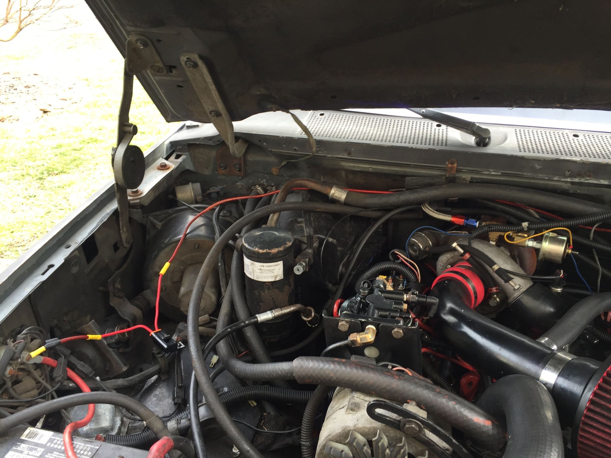

Stock pump turned up a few flats. It was freshly rebuilt when i bought the truck a lil over a year ago. Ain't broke so I didn't wanna fix it.....yet
Performance...it spools up quite nicely and gets around 4 psi relatively quick and holds it up. I did a quickie wrap job on the U pipe and up pipe, but nothing crazy there.
Just got around to plugging the wastegate tube so I'm just now getting accustomed to those boost numbers. At some point, I'll wire the wastegate shut but I'm lazy and it's cold outside at the moment. Probably give it another flat on the IP

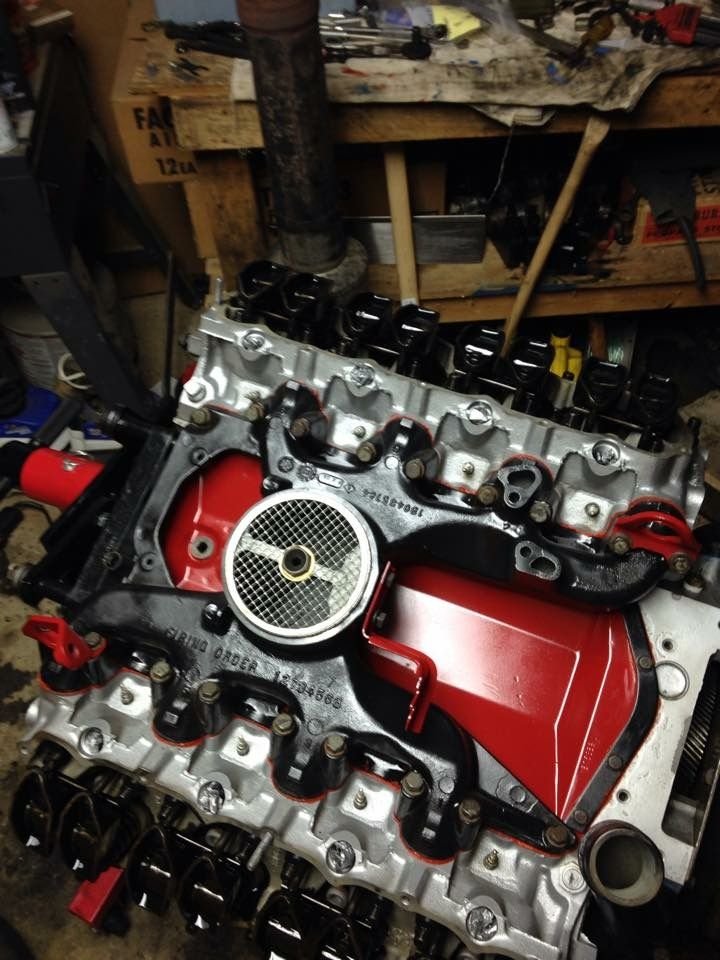

Intake setup....the intake manifold itself is same between N/A and turbo (visible in last photo). There's a stock intake snail available from 93 and 94 models with the IDI (snail is glossy black in my photos)
I only use this truck for hauling firewood around so I didn't really need to dump a ton of cash to get it up to the level I wanted. I had what sounded like a rod knock and had to pull the engine apart so this is what i came out with in the end. Totally unexpected/unscheduled build.

Good shot of the snail without the turbo mounted on it.
