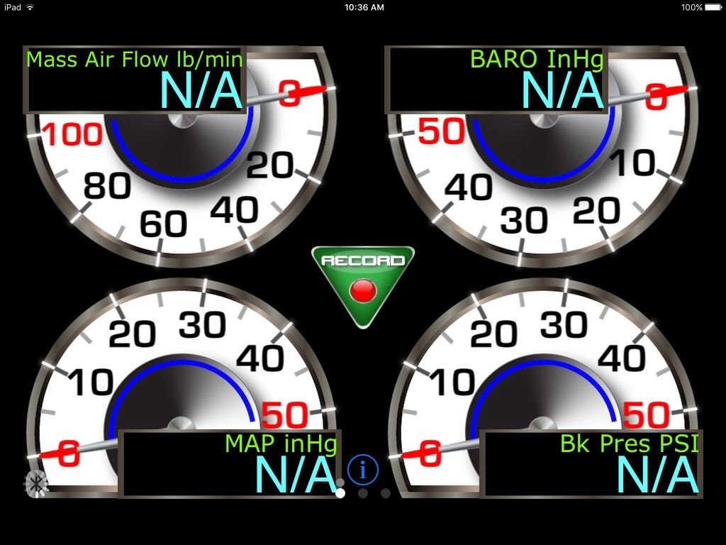

Here's one of my analog looking screens on my Dashboss to evaluate the things you talk about Yahiko. On my digital screen I watch vgt's, boost, along with rpm's to monitor my turbo activity.
