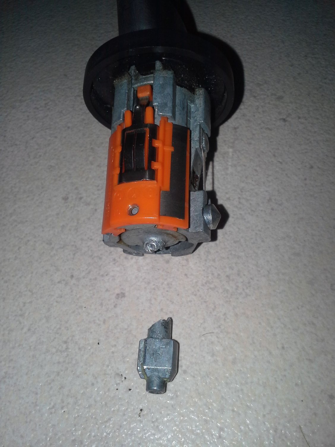

This is what happened to mine, but it was stuck in the ON position. When it snapped, wife was driving it. It died on her while turning right at an intersection. She lost all power brakes and steering. Lucky for her, she was going slow.
