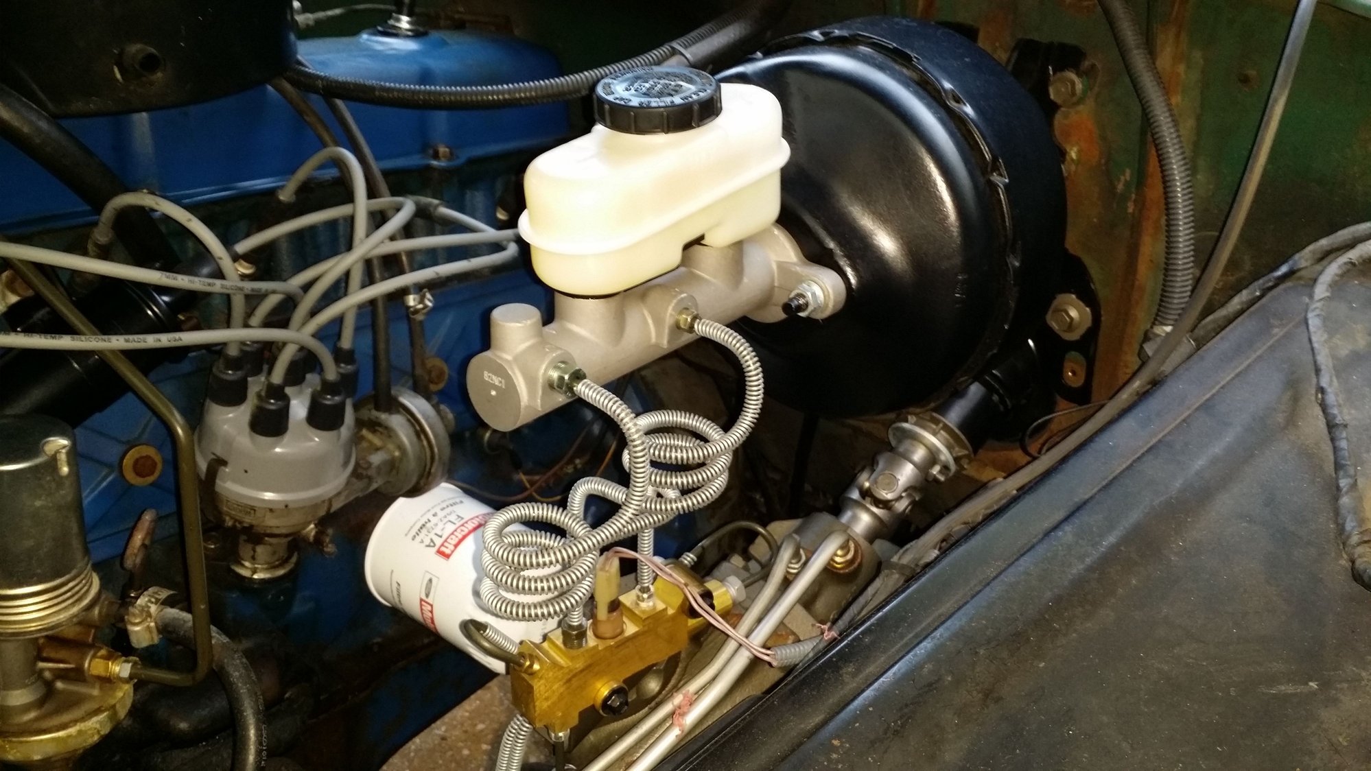

.....Next up brakes and then a license plate. Brake booster is only about 3 years old so I think I'm going to go Ultraranger style with a new universal proportioning valve I had bought years ago and a 94 Ranger master cylinder.
Right Steve?
I take it that currently you have the smaller diameter single diaphragm brake booster? Are you planning to swap to a dual diaphragm F250/F350 brake booster like the '75 F350 dual diaphragm booster that I'm running?
The '90-'94 Ranger 'modern' MC has a 1.00" bore diameter. It also has a plastic reservoir that has a downward slope to it (from the back towards front). This sloping angle won't keep the MC from working but, it just doesn't give a good visual effect. --it looks like the brakes were slammed on so hard that the inertia forces bent the reservoir downward on the front end.
1990-1994 Ranger brake MC. --you can see the slope to the Ranger reservoir I'm talking about.
I'm running a 1995 Ford Explorer 1-1/16" bore 'modern' MC. NAPA part number M3246.
The '95 Explorer MC reservoir sits basically level when the MC is mounted to the booster.

Yep. I do have the smaller diameter single booster. And factory front disc brakes. I also have a used level fluid reservoir off an old girlfriends 1991 f150 I can use. And wire it's low fluid sensor in to the dash's brake warning lamp piggy back. I had bought a new universal proportioning valve off EBAY years ago I plan on using. MBM brand and part number PV2.
This 90-94 Ranger M/C, does it require metric fittings and does it have seats in the ports for standard female double flares?
Old Feb 21, 2016 | 11:31 PM
  #54
ultraranger's Avatar
ultraranger
Joined: Apr 2011
Posts: 6,399
Likes: 40
From: El Dorado, Arkansas
The Ranger MC uses the same ISO metric bubble flare fittings as my '95 Explorer MC --M12 x 1.0 secondary port fitting and an M10 x 1.0 primary port fitting. The MC isn't compatible with SAE double flare lines and fittings.

OK. Can I get aftermarket lines with ISO and metric fittings and double flare the other end of them with American fittings to fit the Prop valve?
