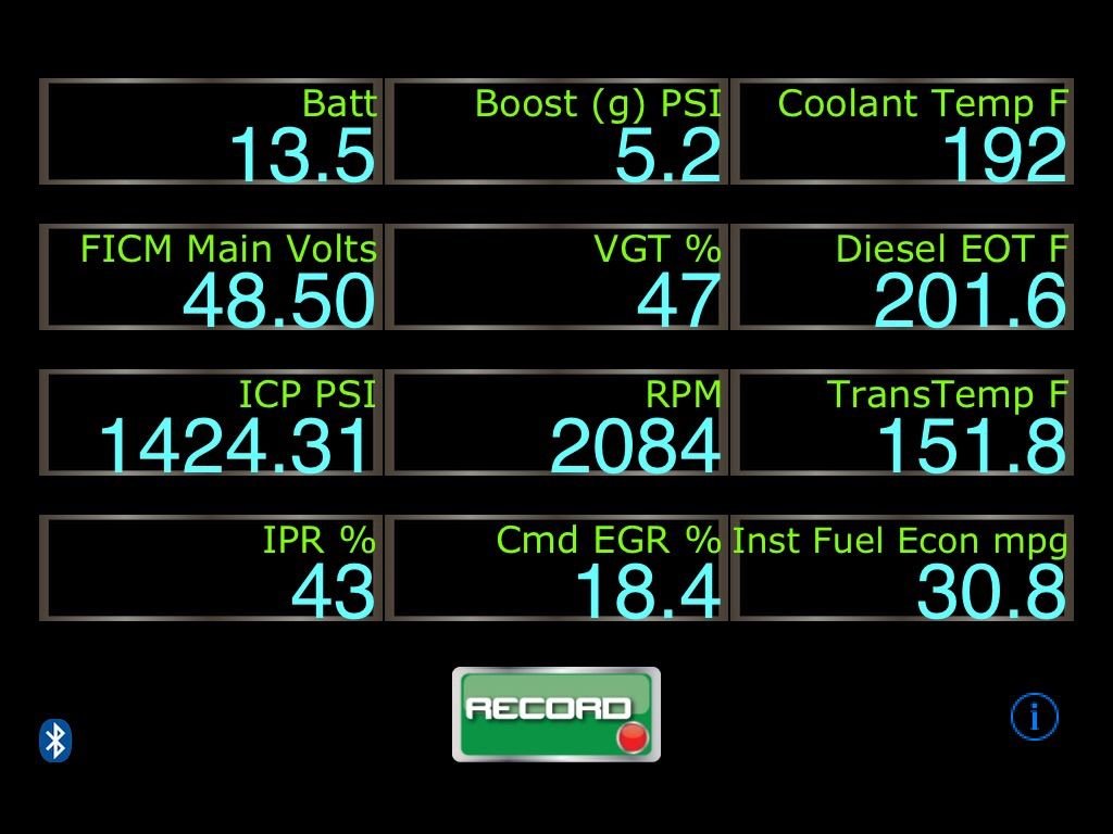

Here's the way I set mine up. Interesting to see how others use the parameters.
My alternator voltage shows a bit lower, but when the 5th wheel is hooked up, I have two 102lb Data safe batteries hooked up in parellel with the stock alternator. Needing to upgrade is on my list.

I like it! I just got it this week. It took me a few months to decide on what to get. This is a great way to be able to monitor the PID's I wanted to along with EGT's and Fuel Pressure without breaking the bank.
I'de love hear your experience with what you see while towing. Planning on taking the 5th wheel on a big trip when the snow melts......I'll be in touch 😎

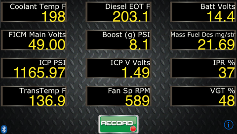

One of my more common main set of PIDs...

Interesting Josh. Why the fan speed metric? Is there something in particular that you look at there?
IIRC correctly I believe that screenshot is from the Summer of 2013 when I was watching Fan RPM related to A/C operation.
Although I didn't switch PIDs too much. The Trans Temp, Fan Speed and mass fuel are the parameters I would change around as I saw fit. The others stayed as they were 100% of the time

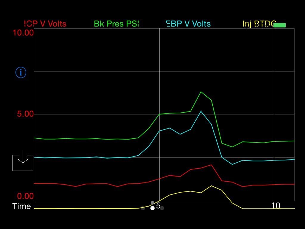

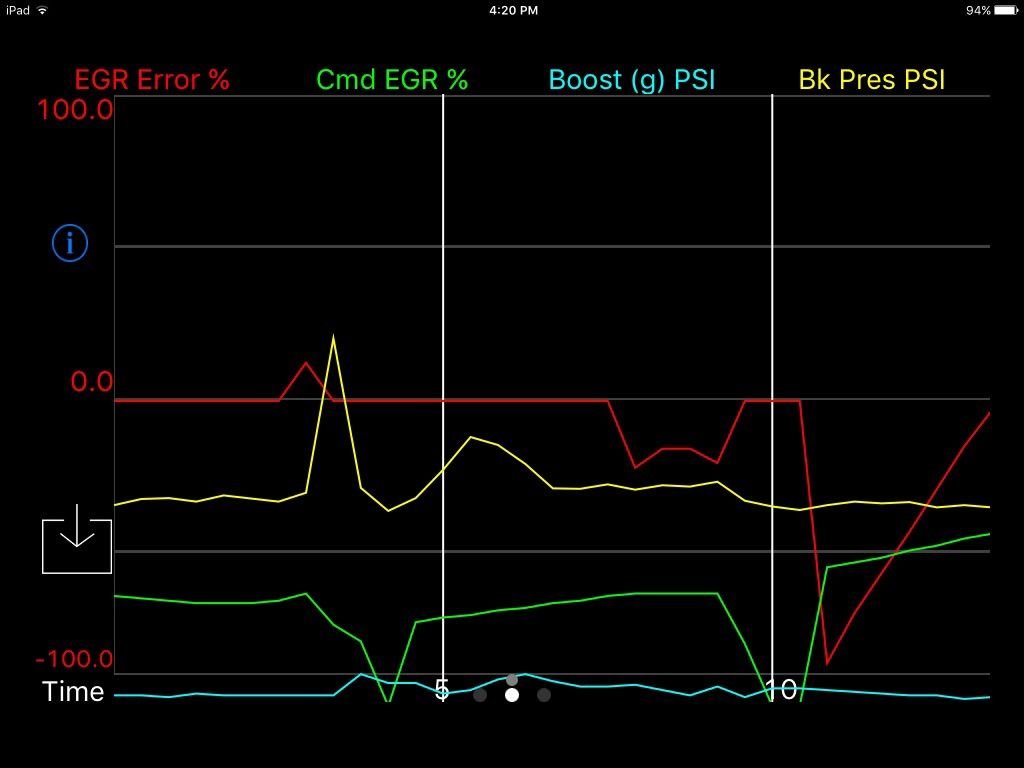

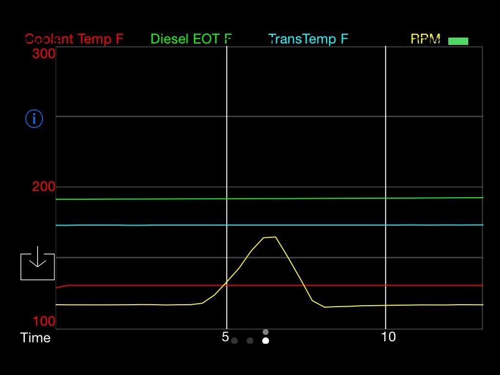

Here's a couple of graphs to show you why I align my metrics top to bottom when recording. It allows similar measurements to be seen on one screen.
I will also add rpm with boost and vgt's to measure acceleration valves.

One more.
And finally.
