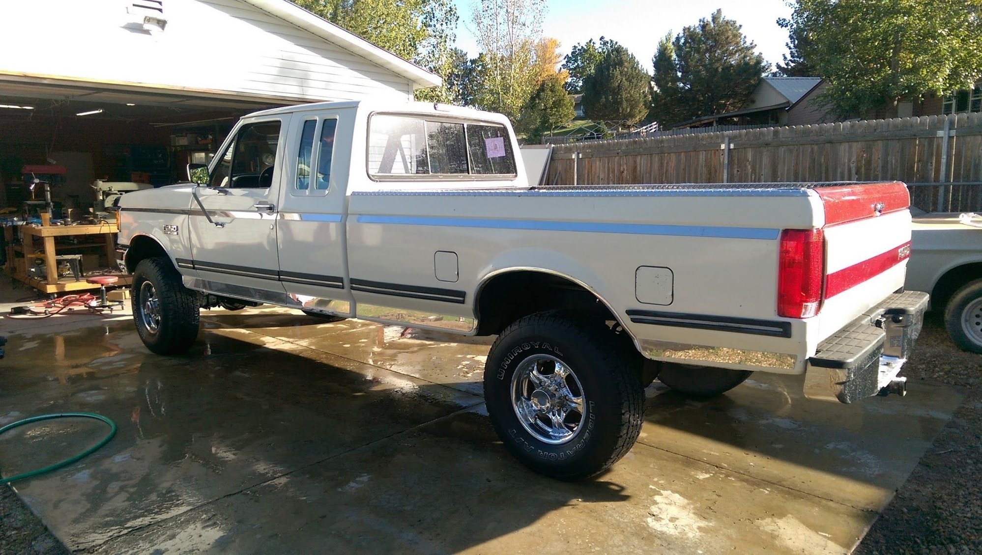

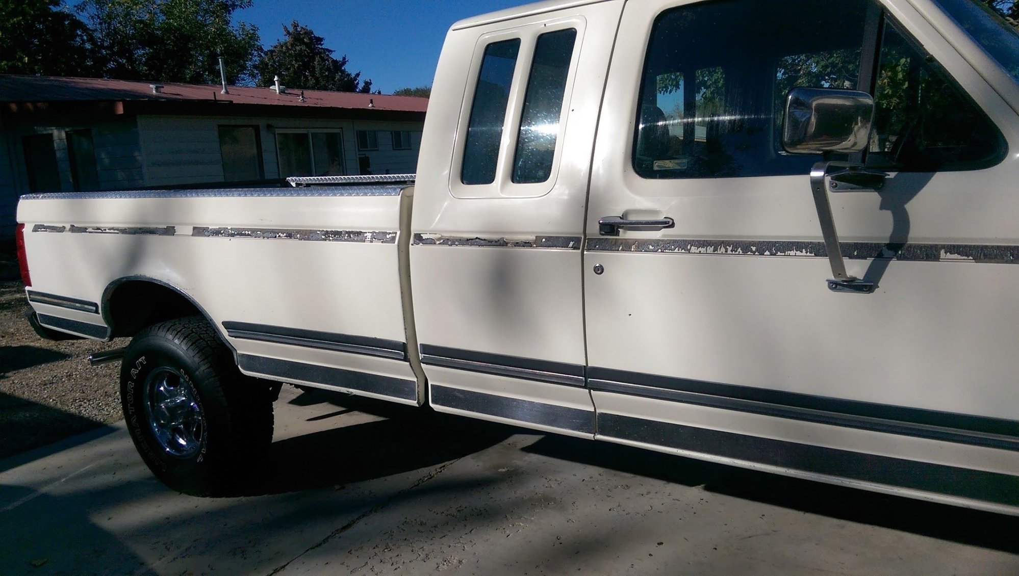

Nice looking truck! I see you are removing the side trim. What are you using on the remaining glue and do you intend to replace the molding, leave it white or paint on a stripe? I removed my molding and some of the paint came with it and there is lots of glue remaining that I can't get off. I am planning on sanding everything smooth, spraying a little high build primer, sanding again and applying 4 inch wide dark Grey vinyl tape I bought off ebay.

Yes, my goal was to completely debadge the sides but I'm having a difficult time getting the factory trim off without taking off the paint.
There were also aftermarket "chrome" strips on it (on the very bottom which is still there and in the "groove" up top) which I just hated- and it came off relatively easy. You can see them in the 1st picture. I used two different sprays. Goof Off and 3M adhesive remover. One worked better on foam remnants, the other on glue residue, cant remember which was for which. Used carefully cause I did feel like it was taking paint off too, just in thin layers. But the aftermarket stuff came off without too much problem. I will do the lower sections as well. Follow it up with a good coat of wax.
There is also some rust on the rear drivers side section under the extra cab window all the way on the bottom. Doesn't seem to be anywhere else. My thought was to bondo it up, and then spray the whole section from the trim line on down with a bed liner type material. Probably wont go with a profressional system, just a DIY. It's an old truck. I'm not going to spend as much as I did on the entire truck for two black strips.
If anyone has ideas on what exactly to spray it with I would be all ears. I'm going for a cleaner look.

The glue on my truck softened the paint and much of it came off with the molding. I guess 24 years in the desert sun will do that. Surprisingly the paint overall is in good condition on the rest of the truck. Today I began sanding off the glue and soft paint. I will primer and paint just where the old molding was and then apply a nice 4 inch wide grey vinyl tape stripe. I got 150 feet of the stuff on ebay and for now this will be the solution. In a couple years I will paint the truck and fix a couple of dings. You have a nice looking truck by the way.
