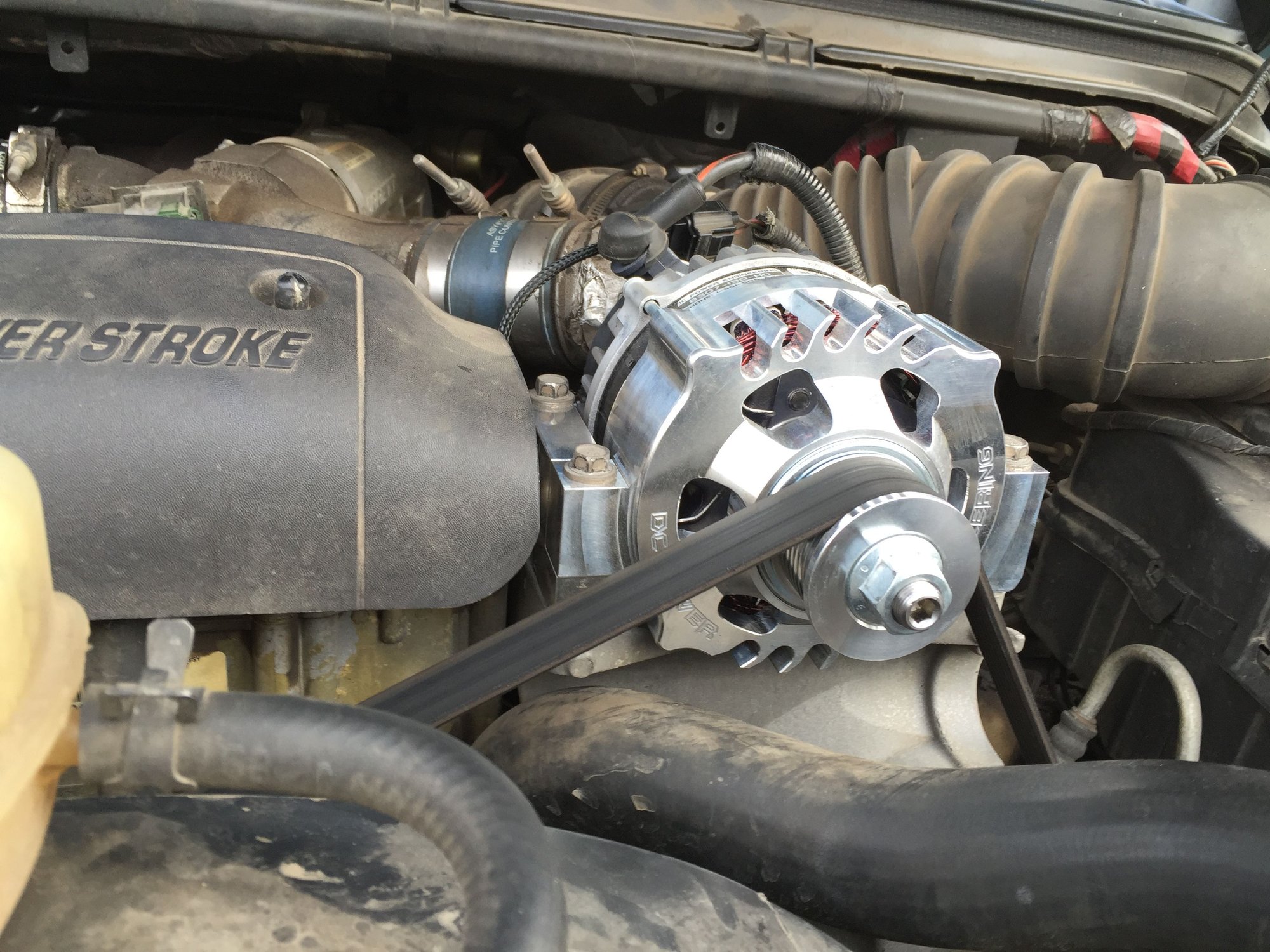

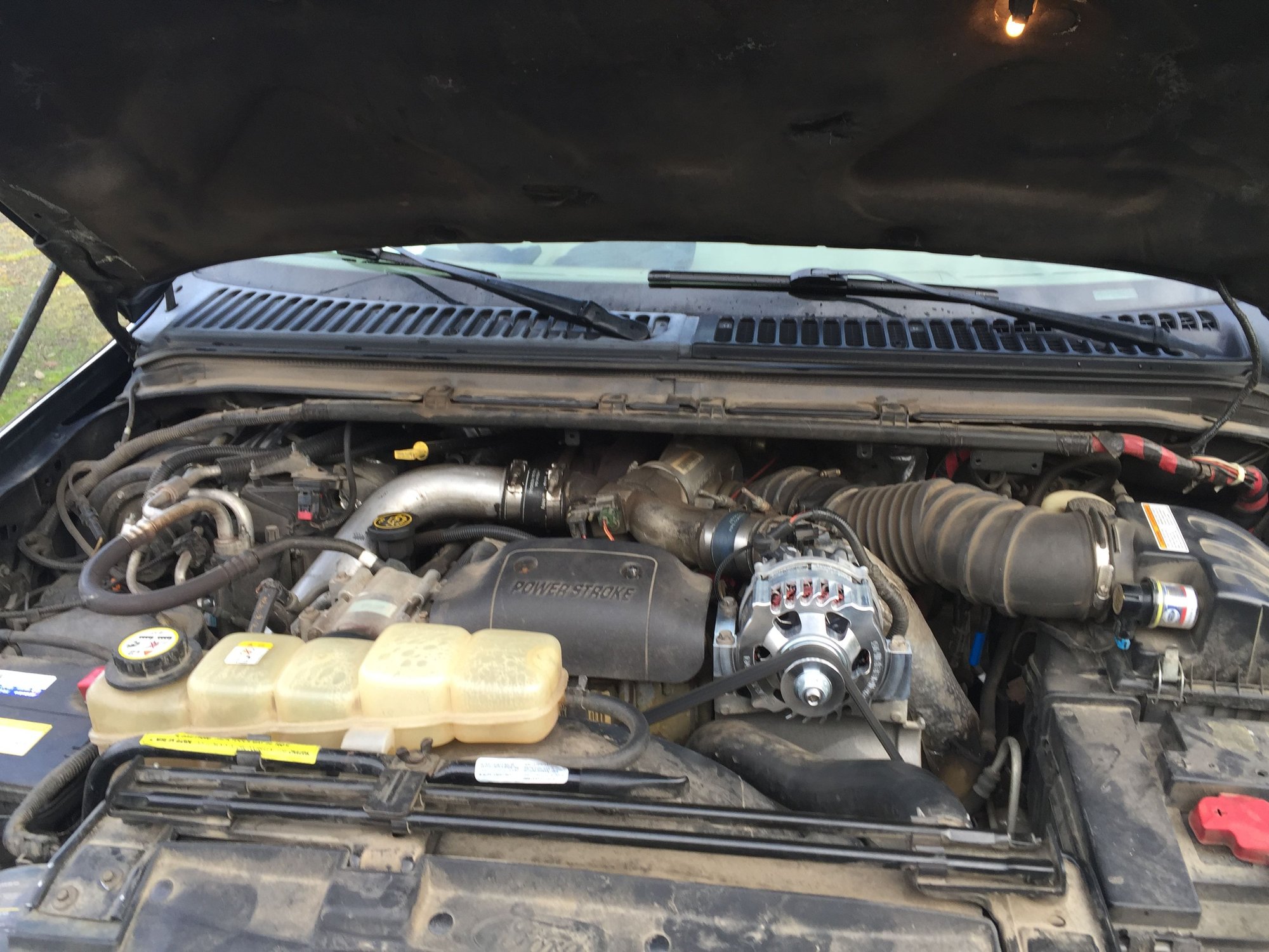

Congratulations - I love my DC270 + wire upgrade I got from Ed as well.
A suggestion for the location of the big fuse, mock up the cable from the Positive battery terminal to the fuse first, I mocked from the alternator to the fuse and used an existing hole in the inner fender. I don't like my short Positive cable resting on the NEG ground cable and being right next to the NEG terminal of the battery. I plan to move the fuse towards the firewall a bit in the future.
Once all the millions of other things I need to do get done.
