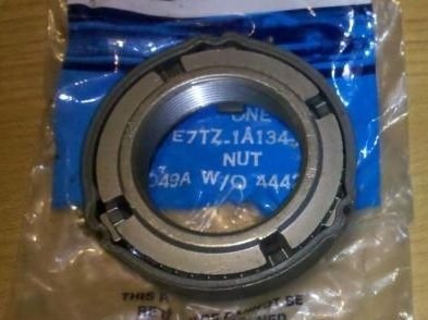

Mine has the one off external manual hubs so it came with these
I am eventually changing it to the more common type so I picked up the front axle assembly from an '86 F-150.
