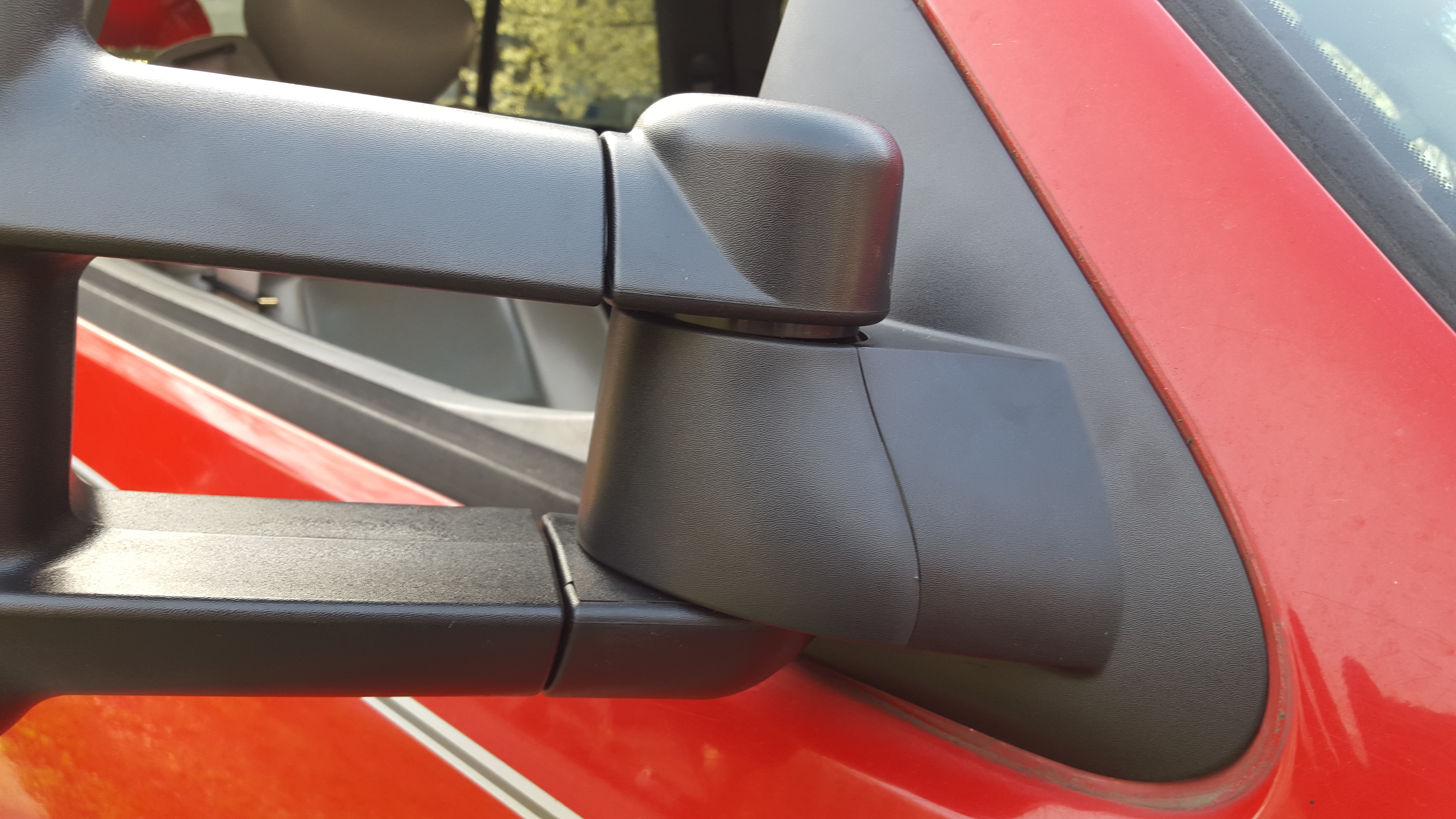

The angle of these really bothered me, so it's time to mod them.
Pop the cover off.
I found this to be the easiest way to get them off.
I loosened up the bottoms just enough to let the top sag and then removed both of the top screws. I had a handful of 1/4 washers so I grabbed those.

Now after spacing these I found that I needed to grind some of the molding on the cap to fit now that the top sticks out a bit further now.
There's a lip on the inside that I ground down flush with a grinder. Not the cleanest but it's hidden once reattached.
I think the driver's side would be a bit more level with four washers. I would imagine that both doors would be symmetrical but the passenger side looks level when viewing from the driver's seat but the driver still seems to stick up just a bit. But I ran out of washers so...

Here we are.
My thoughts so far on one trip to the gas station is that these are way better to see out of. Down sides are that the plastics on the are mount and base don't seem to be a high quality. Poor fitting and loose, even before I popped the cover. The mirror glass also shakes a bit but nothing too bad.
