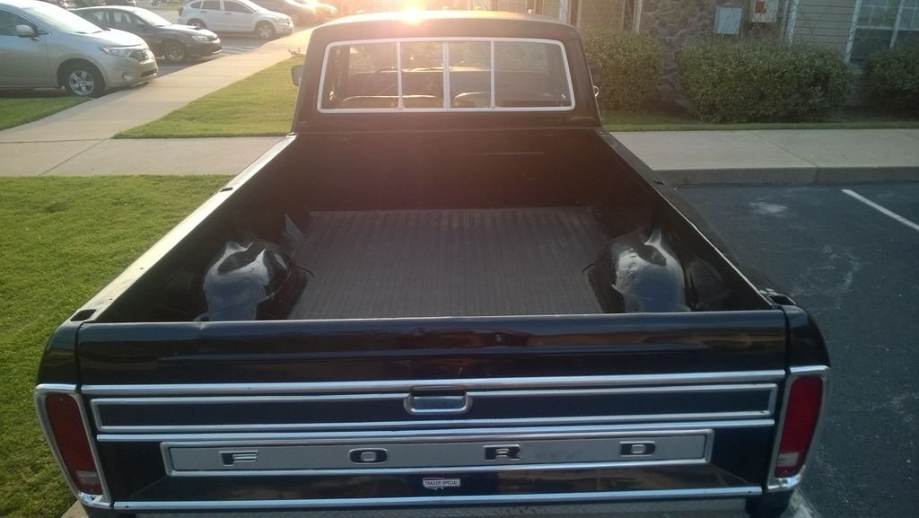

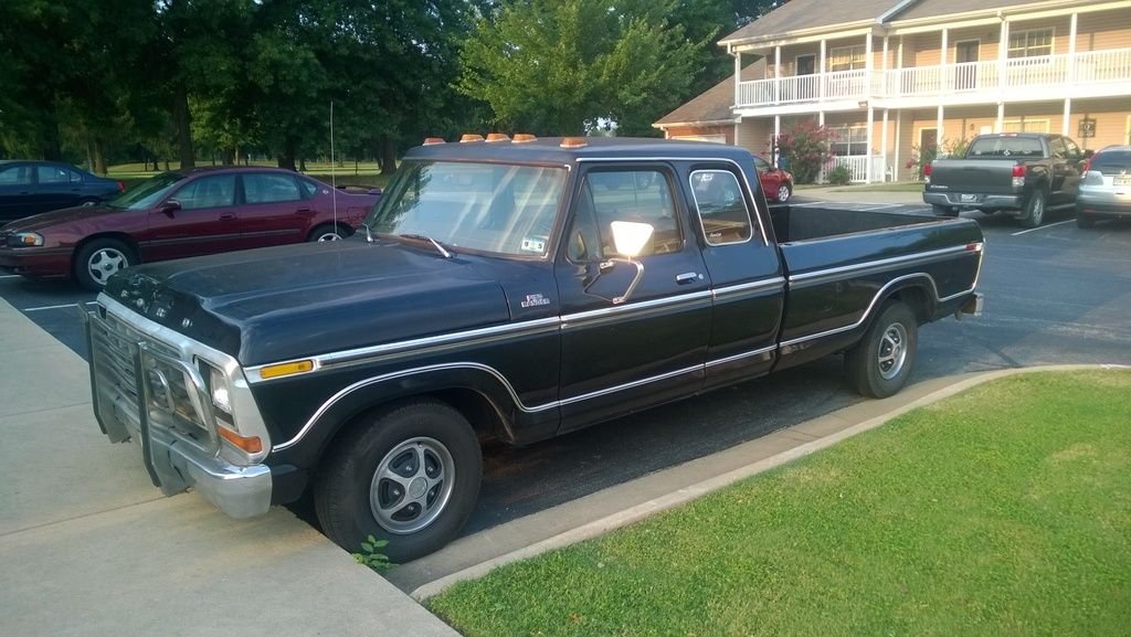

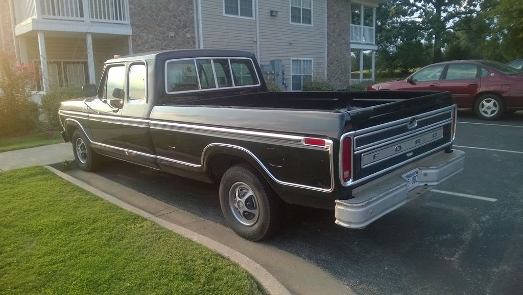

Here's Betty as I found her. Built in California, I think, then wound up in Austin, Texas. I drove her back to NW Arkansas overnight in a constant rainstorm and almost no brakes - and my follow vehicle insisted on leading the parade at a steady 80+ mph.
She's a 1978 F150 Lariat Supercab LWB 460/C6 Trailer Special 2WD. Original Color was the two tone Brown/Cream. PO painted her black, hence the name, Betty (my wife actually named the truck )

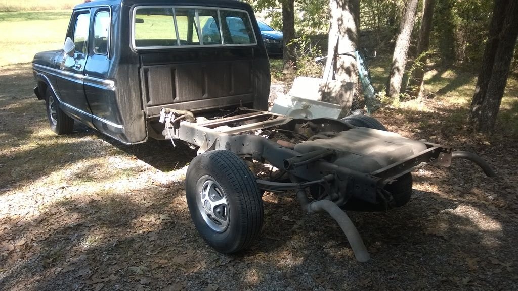

Here's short vid from the first time we pulled the bed off. We restored an old homemade lift that had been hanging in the shop for who knows how long. The gear block on the left read Boston Gear and Tool.
https://onedrive.live.com/redir?resi...nt=video%2cmp4

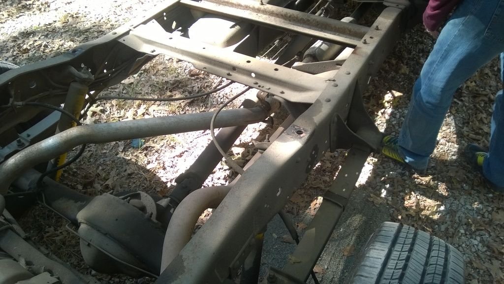

Here's some frame inspection photos. Had to grind the philips head off the passenger side bed bolt just behind the cab. That clip thingy was not letting go. We actually busted an impact driver bit trying to get it out, PB blaster and all.
I was also pretty stocked with the condition of the rear of the cab and corners.
The rubber fuel filler hoses were dry-rotted so we replaced those immediately. It's not fun watching gas hit the ground when you're at the station.
A PO had also by-passed the stock fuel filter fitting and put an inline filter up near the carb. Not sure if it's safe to have it sitting right under the coil like that.
The diff had so much crud on it I thought the ID tag was gone. A good power wash revealed it was just buried though.
