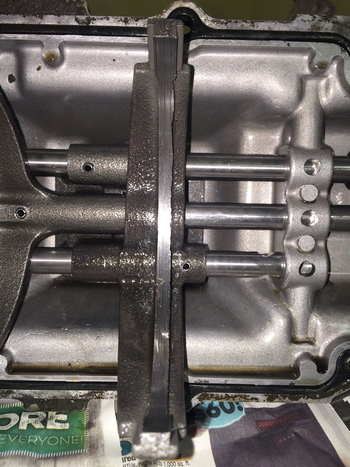

Today I was driving my truck as usual and when I put it in 2nd the shifter went about 2 farther in travel then it normally does and was stuck in gear. Took the top cover off expecting a broken shift fork and found that the 3-4 shift rid was hyper extend in 4th knocking out a plug in the top cover. I will post pictures of the top cover. I replaced the 1-2 shift for 2k miles ago and I'm suspecting the 3-4 fork slipped the collar from excessive wear and that's how it was able to hyper extend. I also lost a shift detent. See attached pictures. Is my hypo this right?

Yeah, I don't see any other way the shaft could have slid that far besides the fork being so worn it slipped off the collar.

Slipping completely off the collar and pushing the machining plug out of the top cover? No, but I know the M5ODs are notorious for shift-fork issues, so it doesn't surprise me.

rookie mistake the shift fork in question is the 1-2 shift fork. It is concerning because the worn shift fork is the one I replaced 2 years ago so something is definitely wrong. I just have to make it work till this summer with a new shift fork.
It was stuck in an exaggerated second gear, someone told me there is a role pin or something that commonly is misplaced that will let the shift rail slide that far forward?

Did you put the parts back in that came out when the rail moved? You said you lost a shift detent. Should have a ball bearing and a spring in the hole and a solid pin that goes in sideways towards the middle rail. They are there to keep pressure on the rail so it won't do what yours did unless the shifter has been forced so hard the rail slips past the hole and the parts come out. Also you needed the plug that got pushed out.
