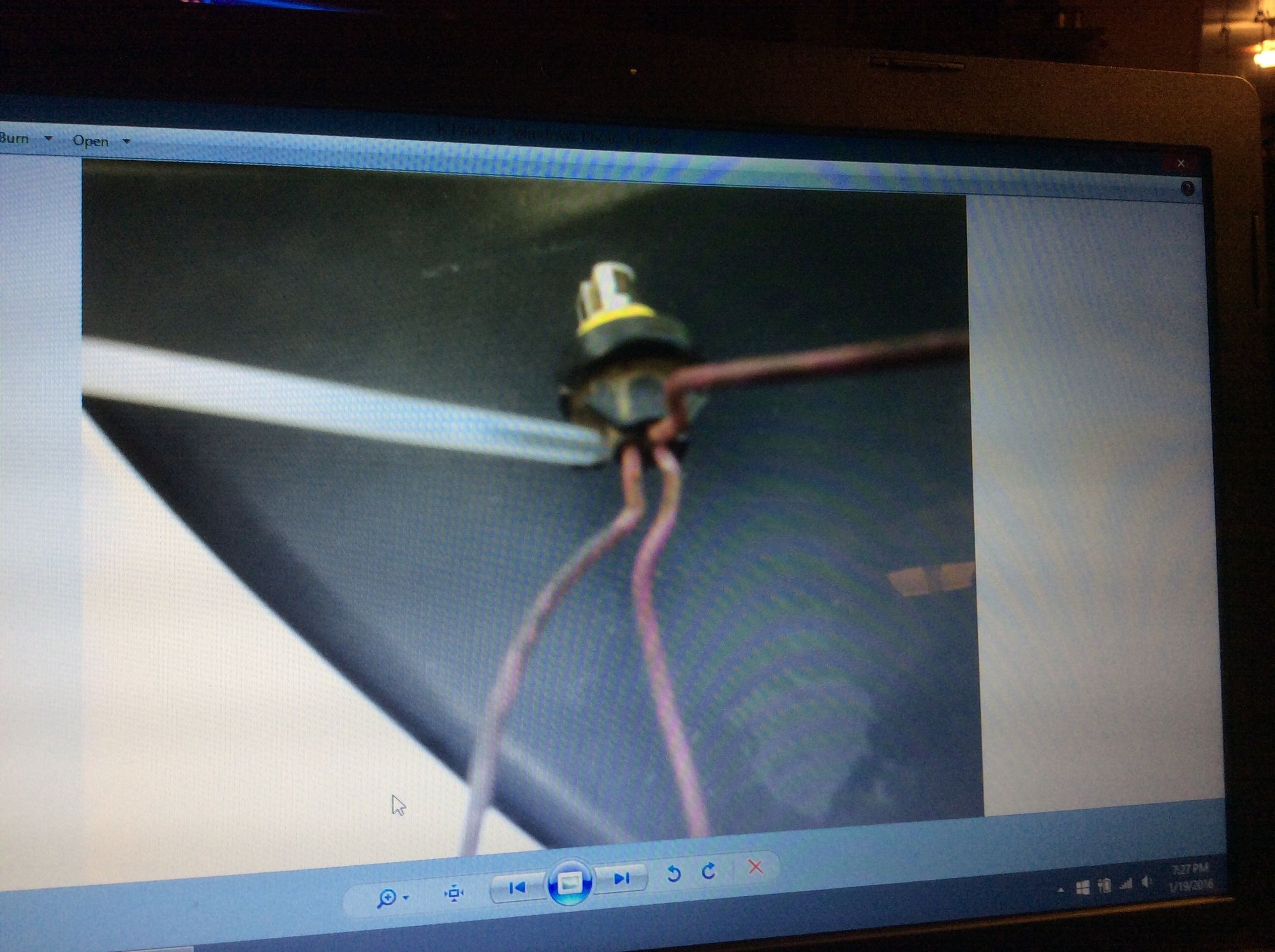

Check your ICP Connection, any oil out the connection side of the ICP sensor?

On the connector is a grey clip that holds the three wires together , don't know why but it shorts out there , take the clip off and spread the wires if you see white in between , that's shorting out.

I will post a picture for you when I get to my lap top, in this case taping them won't work , pigtail replacement is the only remedy, Now you said ICPV is unhooked , let's look at EBP Map, VGT ,baro , do you hear the turbo spool up any weird sounds squealing? When you do these test do them like this In Park radio , HVAC off

for some odd reason I cant post the ICP pigtail short still trying

The white color on the wires

Sorry for the celerity , had to get creative
