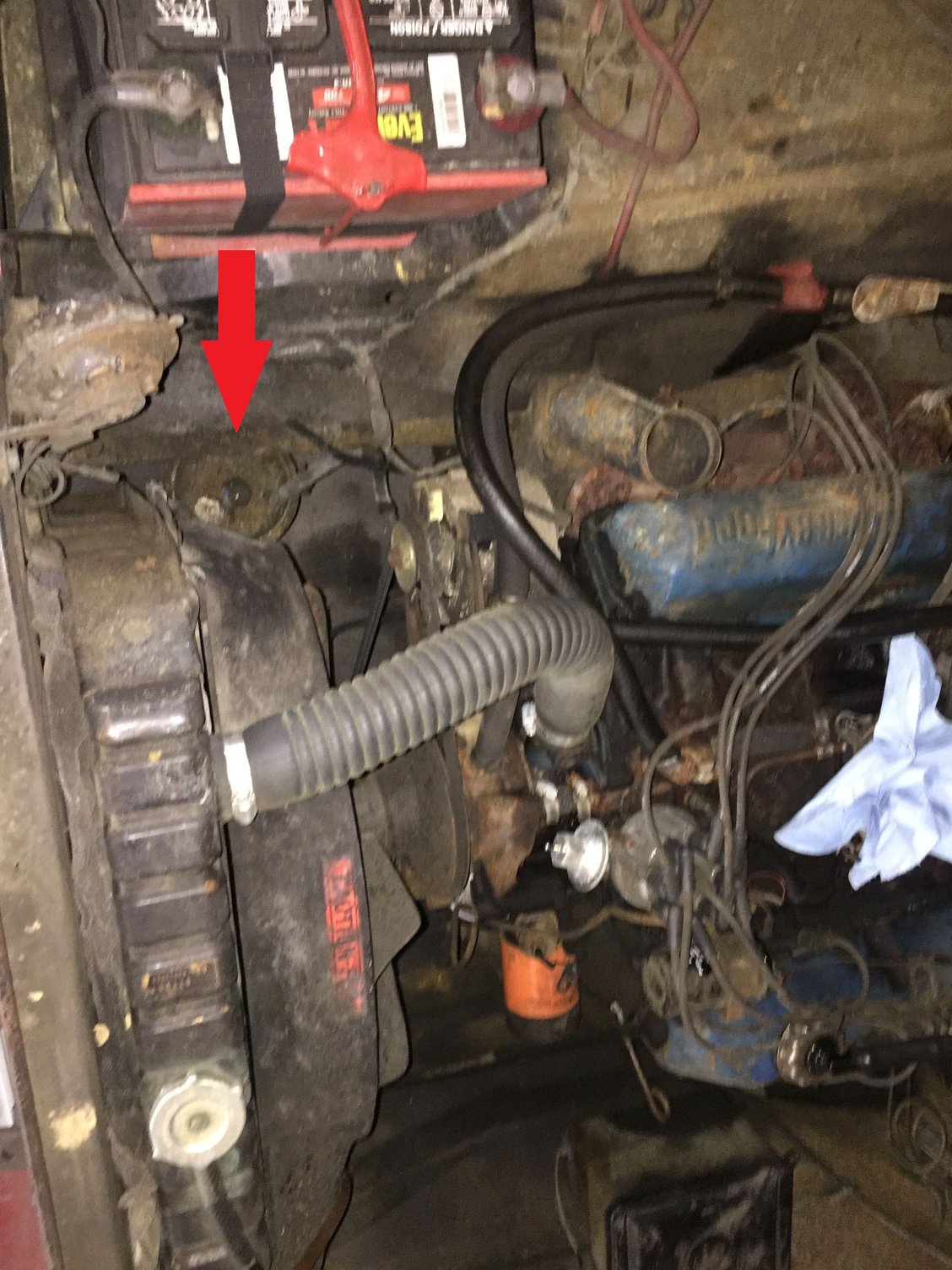

Warning: Dirty engine bay needing of TLC.
For the life of me I can not figure out what this is and what its purpose is. It has a hose that has either been cut or just fallen apart over the years. If you could help me understand what this does and where to route the hose to that would be great.
I will be doing a through cleaning of this engine bay once we get some above freezing temps.
Thanks,
Trever T.

Charcoal canister.

The evaporative emissions charcoal canister is supposed to capture gas fumes from the fuel tank. A foil hose (yours is broken/missing) connects to the intake evacuates the fumes and introduces those fumes to the air cleaner for combustion.
It doesn't require replacement unless the charcoal, for whatever reason, is submerged in fuel.
Leave it for emissions compliance (if subject to visual and emissions testing) or delete the entire system. Remember to replace the gas cap with a non-Evap cap.

Changing the tank to a non-evap tank involves swapping the filler neck, also.
Vented cap will not fit on a non-vented filler neck and vice-versa.

The "Kraft Paper" hose that goes from charcoal canister to the air cleaner is part number D4ZZ9D667A. Universal cut to fit. Prolly available aftermarket also. Or buy it from:

What kind of hose do you think would be a sufficient replacement?
Old Jan 18, 2016 | 09:34 PM
HIO Silver's Avatar
HIO Silver
Joined: Dec 2009
Posts: 20,678
Likes: 82
From: NorCal
"Sufficient replacement"? We prefer "acceptable substitute".
Try your local NAPA shop and have them look up #BK825-4025.... 3/4" X 36" preheater hose/tube.
